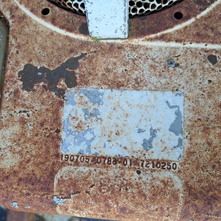

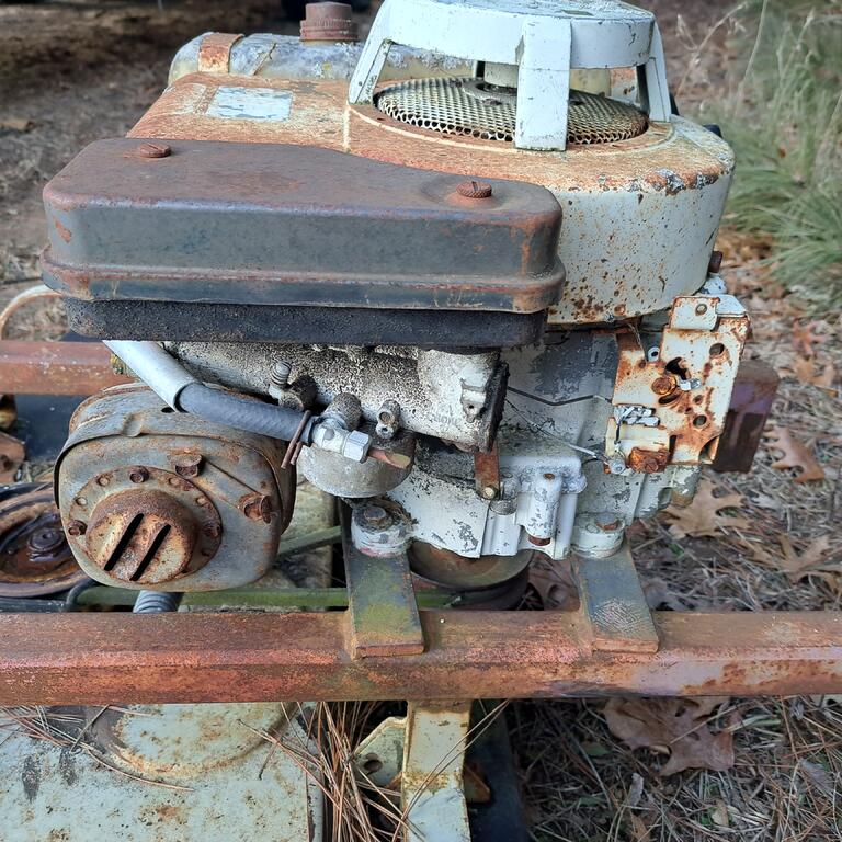

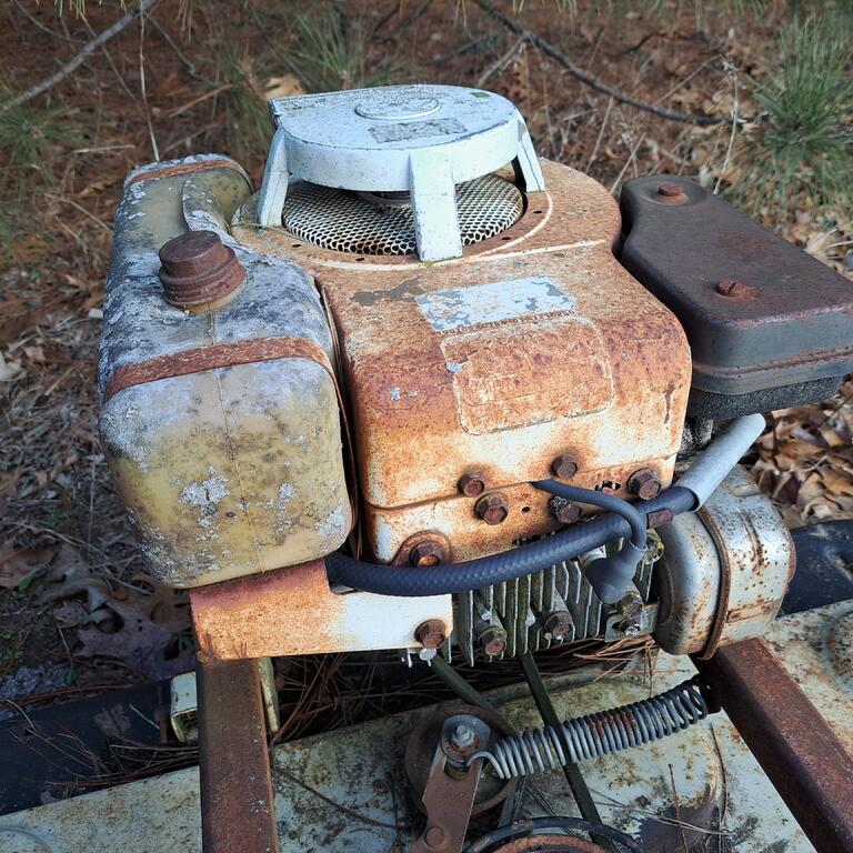

WHX?? 54,981 #10 Posted February 8, 2023 I've got a 8 BS on that homemade brush hog Dan. It hasn't ran in years but maybe saveable? When it ran it didn't smoke. I'll get pics of it. Any thoughts on a predator vertical? 1 1 Share this post Link to post Share on other sites

WHX?? 54,981 #15 Posted February 9, 2023 This is what I got... I see no provisions on the block for starter mounting tho. 1 1 Share this post Link to post Share on other sites
