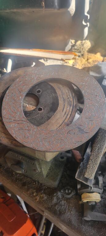

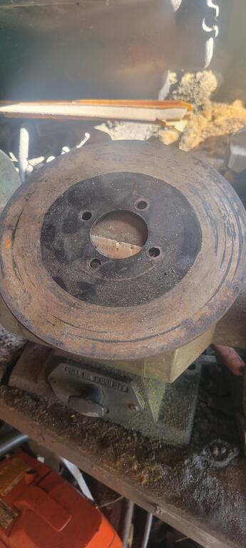

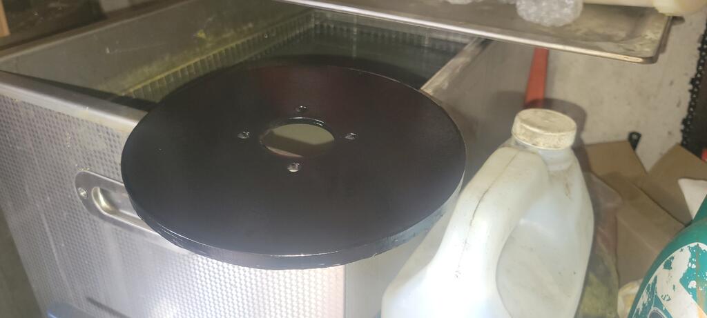

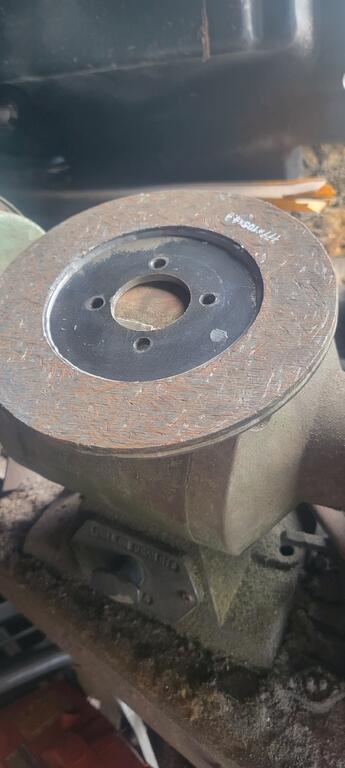

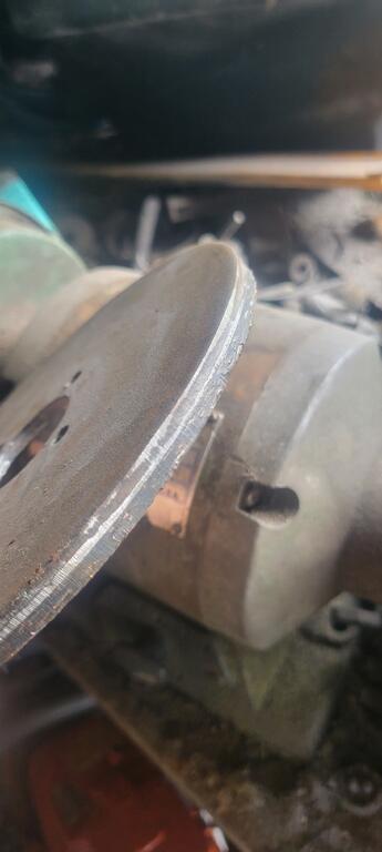

RED-Z06 2,700 #5 Posted February 7, 2023 I ordered B2354R off Amazon, cleaned and degreased my plate, then used JB Weld to adhere the new plate, making sure it was centered, then clamping it in my press between plates overnight, and then trimming the slight excess. Share this post Link to post Share on other sites
