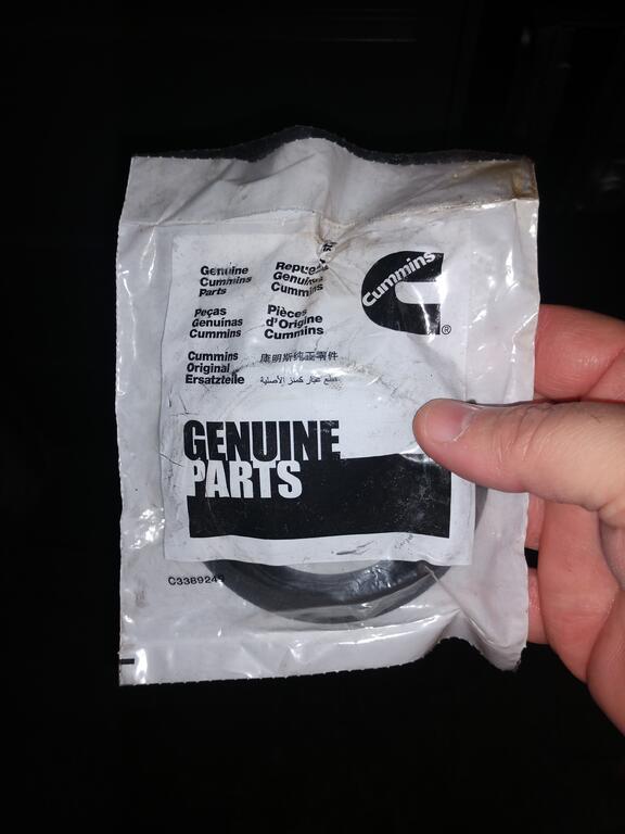

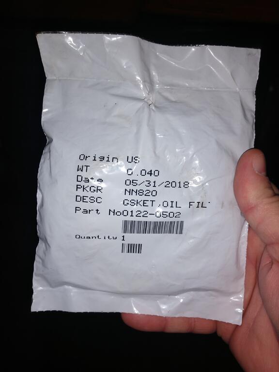

Ed Kennell 43,101 #5 Posted February 4, 2023 Yes, remove the shrouds and clean the cooling fins. With the tins off, look closely for an oil seep between the oil filter base plate and the engine block. This plate is held in place be two bolts that have a history of loosening. Remove the plate and clean the surfaces. Then glue a new gasket to the base plate and reinstall. Any oil leaks around the filter are blown across the rear cylinder cooling fins where the grass will adhere and clog the fins. After cleaning, make sure the rubber oil filter gasket ring that seals the filter to the tins is in place. 3 Share this post Link to post Share on other sites
Handy Don 14,658 #6 Posted February 4, 2023 3 hours ago, Ed Kennell said: After cleaning, make sure the rubber oil filter gasket ring that seals the filter to the tins is in place. This seemingly innocent bit of foam rubber is absolutely critical to proper cooling of the oil and the rear cylinder--DO NOT run the engine without one (they are the same on P216, P218, or P220)! Replacements are cheap (<$10). 2 Share this post Link to post Share on other sites

biltno 32 #10 Posted February 4, 2023 Thank-you for all this great information! something is bothering me now... The 520H I bought used had maintenence records from the dealer. I used the 520 maybe 8 times to mow the lawn that takes about an hour. The seal that goes around the outside of the oil filter was missing. Did I cause damage from overheating it ? the engine sounded fine when I idled it down when i was finished. Obviously, I am not running the engine again until I replace it. 2 Share this post Link to post Share on other sites
Ed Kennell 43,101 #11 Posted February 4, 2023 13 minutes ago, biltno said: Did I cause damage from overheating it ? Probably not. If you overheated it enough to loosen the valve seat, it will let you know. 1 Share this post Link to post Share on other sites
Handy Don 14,658 #12 Posted February 4, 2023 59 minutes ago, biltno said: Thank-you for all this great information! something is bothering me now... The 520H I bought used had maintenence records from the dealer. I used the 520 maybe 8 times to mow the lawn that takes about an hour. The seal that goes around the outside of the oil filter was missing. Did I cause damage from overheating it ? the engine sounded fine when I idled it down when i was finished. Obviously, I am not running the engine again until I replace it. Agree that probably haven’t caused much, if any damage, but I wouldn’t push your luck any further! I AM startled AND disappointed that a dealer handling that machine would not have replaced that seal. Any tech who knows Onans would be all over that. 1 Share this post Link to post Share on other sites

lynnmor 8,086 #14 Posted February 5, 2023 2 hours ago, biltno said: Thank-you for all this great information! something is bothering me now... The 520H I bought used had maintenence records from the dealer. All the more reason to do the basic maintenance we are talking about. I had some warranty work done on my backhoe by a large dealer and it was returned to me with all six bushings missing. With the oil filter seal missing you can run the Onan all you need to if you are just moving it around, just don't put it under heavy load. I have pulled heads to de-carbon and never found enough to have made it worthwhile. I run my Onans full throttle when working them, so that may be the reason for no appreciable carbon but in your case it may be a good idea to pop the heads since there is no way of knowing how it was treated. If you are going that far, do a compression test first to see if the valves are sealing properly. If you find low compression the valves are easily removed since everything is out of the way and no additional gaskets would be needed, only two valve seals. Hopefully we are not scaring you too much, all the things mentioned in this thread are just normal procedures that many just ignore. The bottom line is that treating the engine right should give you years of service. 2 Share this post Link to post Share on other sites
kpinnc 15,715 #15 Posted February 5, 2023 4 hours ago, Handy Don said: Any tech who knows Onans would be all over that. So true. Unfortunately things like certification mean more now than understanding how to read a service manual. Freaking idiots these days, and it's frightening. The oil filter seal mentioned above is in the pic below. 2 Share this post Link to post Share on other sites
NA73 82 #16 Posted February 6, 2023 hmm, first I've heard about the oil filter to tins rubber. I don't think it was even mentioned in the onan p220g pdf but did see it after checking the 520h pdf - looks like toro# 82-0680. Guess it's time to get one since mine didn't come with it. 4 Share this post Link to post Share on other sites
