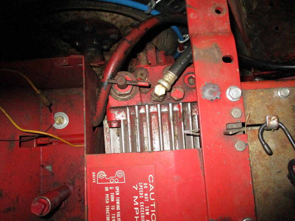

GLefevre555 1 #1 Posted January 19, 2023 I have a '69(I think, I bought it used with no hood for 50 bucks at a garage sale) charger 10 Automatic, and it blew the banjo bolt off of the top of the transaxle that feeds my hydraulic lift. I can't find the thing, and was curious what size the bolt was if anyone has any recommendations for the size and kind. And what kind of trans fluid does it take, I'm not too familiar with these older smaller wheel horses. 1 Share this post Link to post Share on other sites
pfrederi 19,940 #2 Posted January 19, 2023 (edited) Welcome Which one. Most use an O ring. probably Dash #905 Edited January 19, 2023 by pfrederi Share this post Link to post Share on other sites
pfrederi 19,940 #3 Posted January 19, 2023 (edited) Or the fitting (Silver with Black hose) That is an SAE #5 ORB. needs a dash #905 oring. Double check threads are 1/2 NF Edited January 19, 2023 by pfrederi Share this post Link to post Share on other sites
