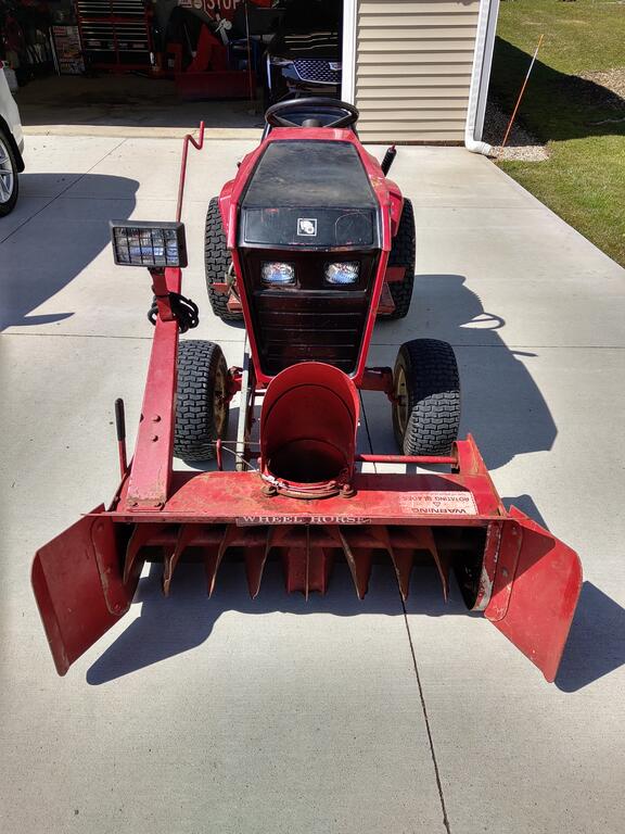

ML3 1,955 #16 Posted March 30, 2023 Ultimately I'll try to end up with a 520 or something similar with a 2 stage blower. Also I'll probably install a rear brinley blade. I did use the single stage on C105, however we had it was an unusually mild winter. It seemed to move 5-8" of snow. I need to get tires as they are original so they are dried up some & a bit worn. Have about 100lbs on rear hitch along with my 200lbs on seat. Wheel weights would be great. I have a new concrete driveway so chains aren't gonna happen! 2 1 Share this post Link to post Share on other sites
