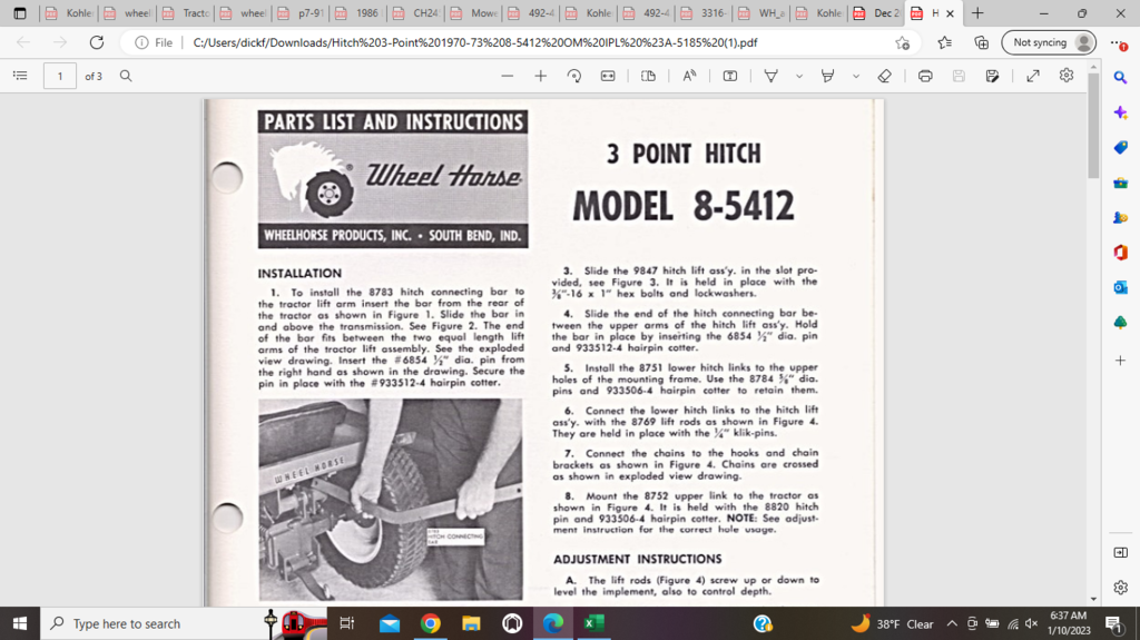

953 nut 64,340 #4 Posted January 10, 2023 Most GT-14 three point hitches are operated using the mid lift cylinder attached via a very heavy duty bar as seen in this photo. This is why I made mention of a separate lift cylinder for the Super C. The three point on the C-195 is more like the "D Series" than the GT-14. The lift arms are the same on all three. 1 Share this post Link to post Share on other sites
