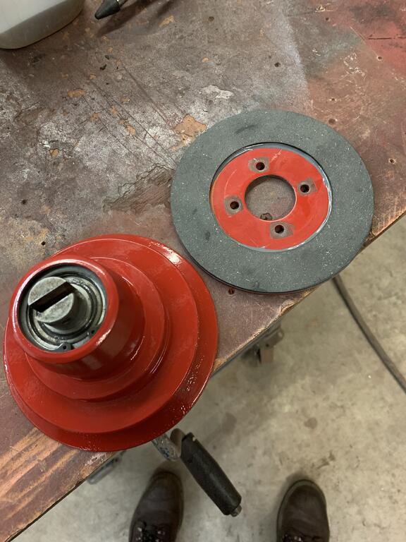

Sparks58 52 #33 Posted January 22, 2023 (edited) On 1/11/2023 at 3:32 PM, Pullstart said: For the PTO? Is it not an electric PTO? I located the original wire for the E-PTO. Apparently, it was modified. I do need an electric clutch or replacements for the Hub and friction plate. Edited January 23, 2023 by Sparks58 1 Share this post Link to post Share on other sites
Sparks58 52 #34 Posted January 23, 2023 On 1/11/2023 at 4:58 PM, Blasterdad said: Looking good! That pulley bell is torched! The rivets ate it up, is the one behind it in your pics good? If not I have one... The one behind it good but the diameter of the outer pully is smaller. Is that not the one for the rotary deck drive? If the inner is it, I'm covered on the bell. 1 Share this post Link to post Share on other sites
Blasterdad 3,167 #35 Posted January 23, 2023 Inner pulley is for the deck, outer is for snowblower... 1 Share this post Link to post Share on other sites
Sparks58 52 #36 Posted January 23, 2023 2 hours ago, Blasterdad said: Inner pulley is for the deck, outer is for snowblower... Great news! I have a replacement for the bell then. Looking for disc or new friction surface now. Thank you. 1 Share this post Link to post Share on other sites
Blasterdad 3,167 #37 Posted January 23, 2023 2 hours ago, Sparks58 said: Great news! I have a replacement for the bell then. Looking for disc or new friction surface now. Thank you. A couple of places for new ones... https://wheelhorsepartsandmore.com/product/94-6650-clutch-plate-assembly-wheel-horse/ Share this post Link to post Share on other sites

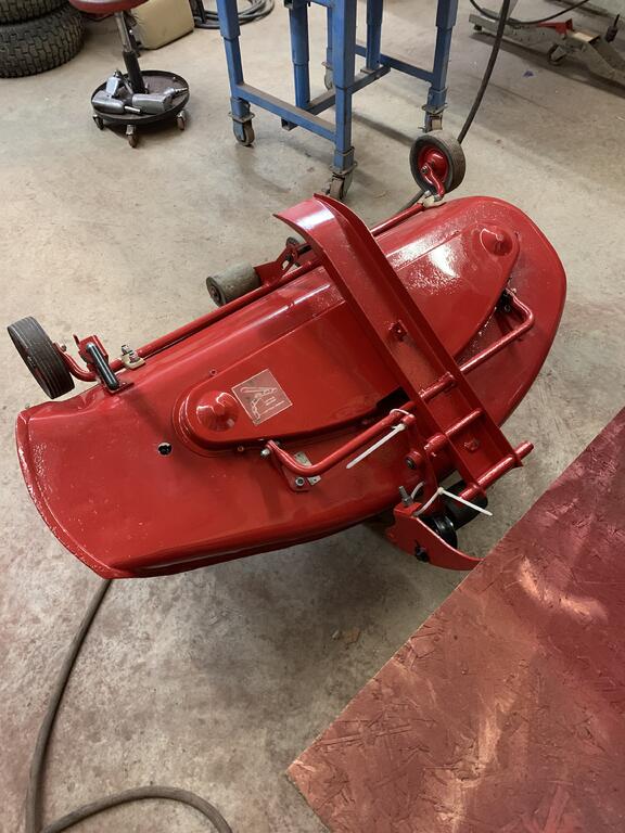

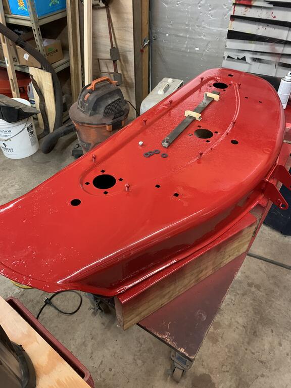

Blasterdad 3,167 #40 Posted January 24, 2023 (edited) Looking good! I rebuilt a deck just like yours last year, I converted it to a newer Tach-A-Matic carrier system. Those decks are SOLID & mow great! It'll be headed for the paint booth in the spring. The only problem was the fully enclosed belt gaurd design. It traps dirt, grass, & moisture, which eats up the tensioning bar's plastic bushings & guides. The newer style decks had a 3 piece guard system which allows you to be able to blow / wash all that out. I leave the cover off my older decks so I can clean them after each time I mow, (I'm the only one who operates my tractors & don't have kids or pets around to worry about). I'm not suggesting you do the same, just take the cover off occasionally, or in the fall when you're done mowing for the season & clean it out good. The is looking good too... Edited January 24, 2023 by Blasterdad Share this post Link to post Share on other sites
kpinnc 18,740 #41 Posted January 25, 2023 1 hour ago, Blasterdad said: leave the cover off I leave the covers off of all of mine (except the 60) for the same reason. Tractors with full steps pretty much cover the spindles anyway so far as where feet can go. If you decide to leave it on, just be sure to remove it and clean the spindle area regularly. On the 42SD, the grass isn't the only problem. That stamped depression acts like a swimming pool for condensation and it will rust no matter what you paint it with. Share this post Link to post Share on other sites
