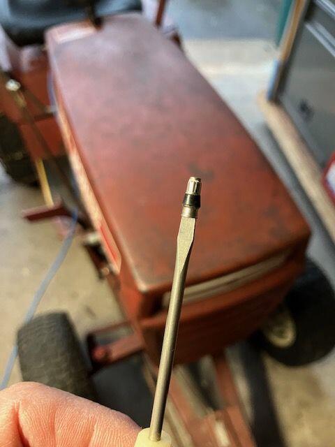

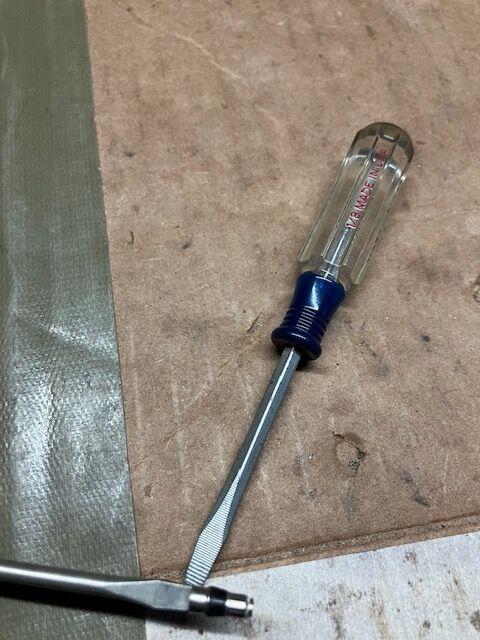

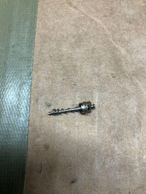

Putting chains on today being January! On both tiers this happen to me. Old Sears 22's tiers on the B-80 the way I bought it. I always take the air out. So both of these Valves where shot. So, after:ranting::angry-screaming: this: I thought, I do not want to take tier and weights off. I found this old screwdriver BINGO that did the trick. Easy peeszy. And as Mack the mechanic used to say that`s is getting you :twocents-02cents: worth.
