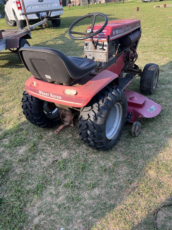

Tonytoro416 1,309 #18 Posted January 4, 2023 18 hours ago, RedPower47 said: Exactly, the hubs on the 417 are flush with the end of the axle and also tight up against the axle housing so there is no room to move them. I may just end up going with 8.50's because i dont want to find out the hard way after i pay all that money for a 10.50 and they dont fit. Hard to see but these tires are 10.50 on my 416h. It has 1/2” spacer on each side Share this post Link to post Share on other sites
