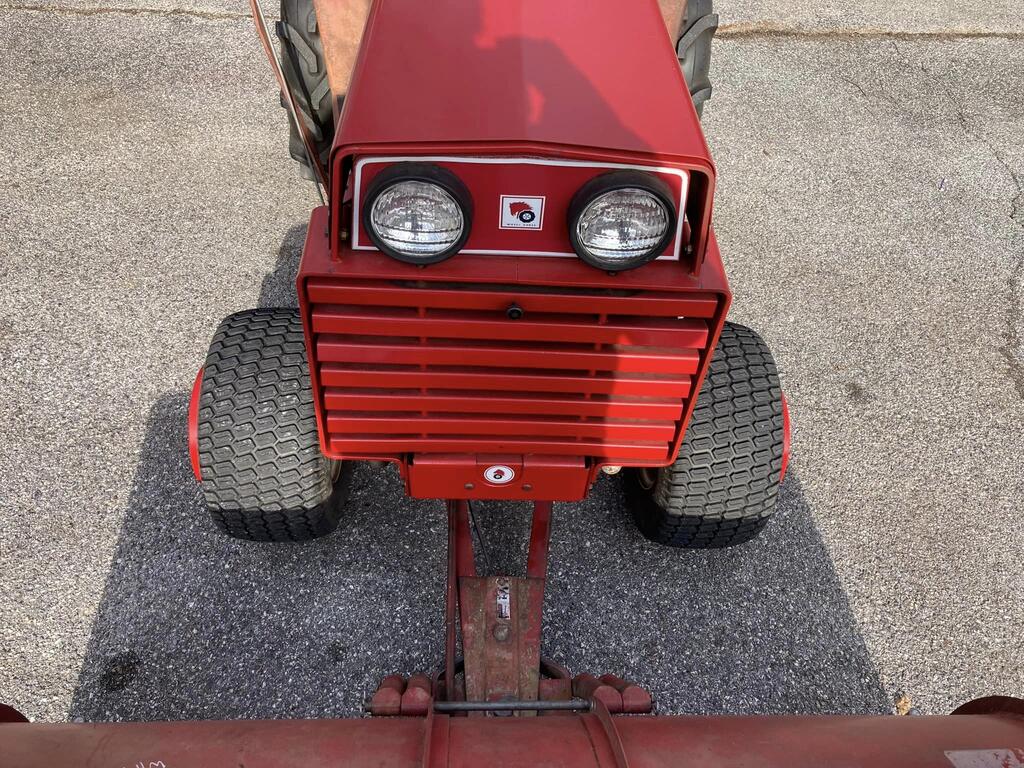

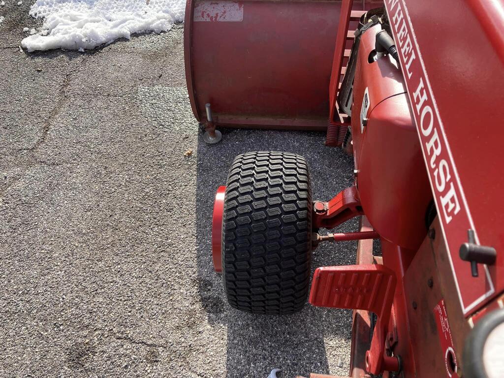

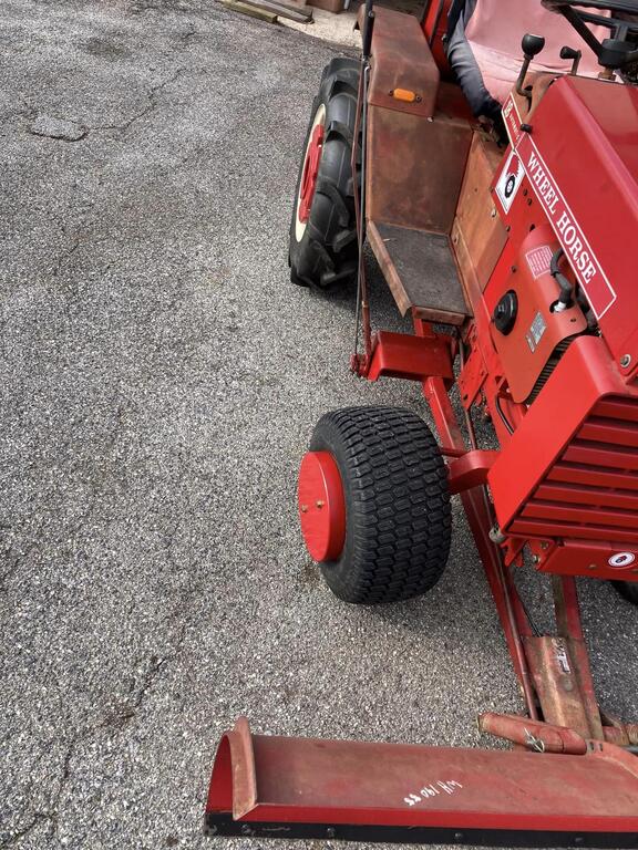

"Manic-Mechanic" 1,420 #1 Posted December 27, 2022 Finally mounted the 50+ Front Weights, only complaint 6" #8 bolts could've been 1/2" longer for ease of installation. (6" #8 bolts with flat washers and metal lock nuts) 18" on center of the Bell Crank and Drag Link The Toe In is at 40.750 rear and 40.500 front. getting to 1/16-1/8 would be a Royal P.I.T.A.! Lol! Steering has improved, must check tire pressure before use! Another coat of slippery and she's all set! 3 3 1 Share this post Link to post Share on other sites
