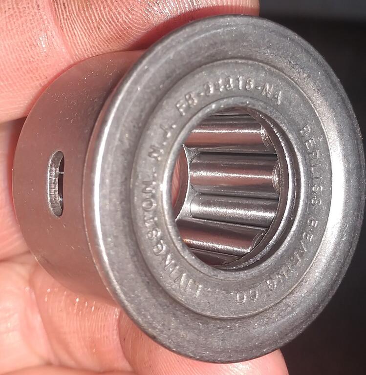

kpinnc 19,007 #26 Posted January 3, 2023 29 minutes ago, ebinmaine said: I like the look of those. I agree with Don on the "trailer hub" upgrade. It's the best option, and can handle the most abuse. I don't think they come in anything smaller than 1 inch though. But the wider bearings in my pic is about the best option for 3/4 axles. 1 Share this post Link to post Share on other sites
ebinmaine 80,929 #27 Posted January 3, 2023 1 hour ago, kpinnc said: I agree with Don on the "trailer hub" upgrade. It's the best option, and can handle the most abuse. I don't think they come in anything smaller than 1 inch though. But the wider bearings in my pic is about the best option for 3/4 axles. Absolutely. I've done the changeover on another tractor. Works Excellent. 1 Share this post Link to post Share on other sites
"Manic-Mechanic" 1,486 #28 Posted January 4, 2023 (edited) On 1/2/2023 at 9:00 PM, ebinmaine said: I like the look of those. I literally have NO bearings in my front wheels though and can't put any in. I'll be getting more fluid fill soon and updating the front axle. On 1/2/2023 at 8:47 PM, kpinnc said: These bearings also can be helpful. On mine, the longevity is still up in the air, but so far so good. The only thing I don't like is that they have no seals, so an outer grease cap is most helpful. And- I don't think I'd use them if you already have significant wear in the knuckle where the factory bearing rides. I have done the 4 lug 1" trailer upgrades before, however, on the 18 Auto these a factory 1" and the bearings are in excellent shape. Not to get off topic, but the "bearings" have no "bearing" on the weight to ground distribution? Edited January 4, 2023 by "Manic-Mechanic" 1 Share this post Link to post Share on other sites
