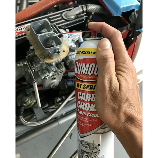

lynnmor 7,945 #12 Posted December 20, 2022 To clean a carb with an aerosol can, I use a spray carburetor cleaner since it is made to dissolve fuel related deposits. I use it for both on the engine and on the bench for blasting small passages. 2 2 Share this post Link to post Share on other sites
