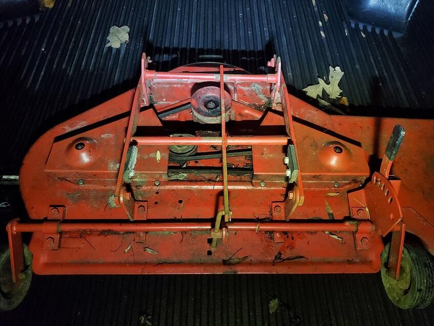

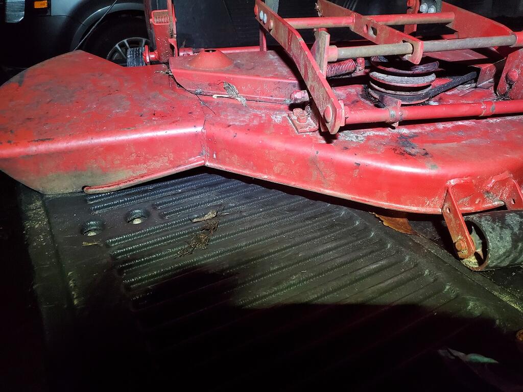

GAJoe 852 #1 Posted December 19, 2022 (edited) I wanted to get the deck model # to be able to select parts in the future. I will be needing belts soon. I didn't realize that there were as many 36" SD decks until I began uploading parts lists. I came up with 8 different model #'s made while the B-80 was also made. year M# 1973-74 5-0721 1975 5-0722 1976 65-36XS02 1976 65-36XS03 1977 75-36MS01 1977 75-36MS02 1977 75-36xS01 1977 75-36xS02 This deck may be none of those. I looked through the manuals and all have a one piece belt cover that at most exposed just the pully that the mule pully is visible. On this one it is two piece and the idler pully is visible. I bought this deck to replace the 48" SD that's in rough shape on my '74 C-160. It came off a B-80 that the PO thinks is '74-'77; not sure of the model #, trying to get it from the person that sold me the deck. I'm attaching pictures hoping it will help. I think that there is only a couple different belts but when I begin the refurbish I need the correct M# for selecting many parts. I appreciate all the help that you guys have given in the past month on the C-160 repairs. Edited December 19, 2022 by GAJoe correct grammar Share this post Link to post Share on other sites
gwest_ca-(File Mod) 12,015 #2 Posted December 19, 2022 Mower DNA 1971 model 5-0710 replaced by 1971 model 5-0711 1972 model 5-0720 1973-1974 model 5-0721 1975 model 5-0722 1976 model 65-36MS01 1977 model 75-36MS01 1977 model 75-36MS02 1978 model 85-36MS01 1979 model 95-36MS00 - These decks use blades with 5/8" x 3/4" center hole unless the spindle has been upgraded ----------------------------------------------------------------------------------------------------------------------------------------------------------- 1979 model 95-36MS01 replaced by 1980-1982 model 05-36MS01 - Last year for bearings with 3/4" ID 1983-1984 model 05-36MS02 - First year for bearings with 17mm ID unless older spindles were updated. These decks use blades with a 3/4" center hole Note - 17mm is .669" 2 1 Share this post Link to post Share on other sites
oliver2-44 11,272 #3 Posted December 19, 2022 That deck looks in good shape for a restore! Try taking some lacquer thinner and gently wipe over the tag several times to remove the paint. Maybe you can reveal enough numbers to narrow the choices down. If you don't come up with the deck number you can take the bearings and seals and belt down to an industrial bearing supply or possible you NAPA. They can measure the old ones and supply new ones. I'm not familiar with that deck, but if it has one pulley mounted on a flat metal slide bar, be sure to replace the 2 black plastic & steel washer/bushings under it. Wheelhorse parts and more has them. Once you remove all the hardware, carefully look the deck shell over for cracks, especially where the rear deck wheels attach and the deck lifting hardware attaches. i think the cracking was a bigger problem on the larger decks than the smaller decks, but now's the time to find any cracks. 2 Share this post Link to post Share on other sites
