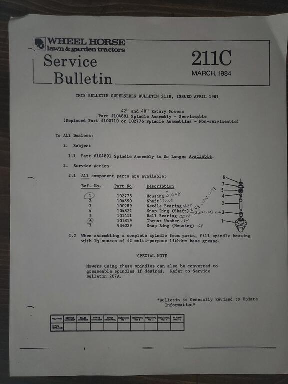

GAJoe 852 #1 Posted December 11, 2022 I bought my C-160 it was from the original buyer's family. They had all of the manuals and paperwork. This service bulletin was included. The part #'s may be superseded by now but I thought it may be helpful. 1 Share this post Link to post Share on other sites
peter lena 9,782 #2 Posted December 11, 2022 @GAJoe that is helpful , think most important thing about new parts and breakdown detailing is the opportunity to do a re grease on the new bearings . since doing that on all my related bearings , there is no whining noise , no failures and no related bearing drag / struggle to move under heat / load . you are right there with a new bearing , why not insure the grease will stand up ? lucas 560 deg rated grease , is what you want to change to . also do related mule drive bearings , and pto lever bearings , that makes for super smooth easy , deck operation , pete 1 Share this post Link to post Share on other sites
