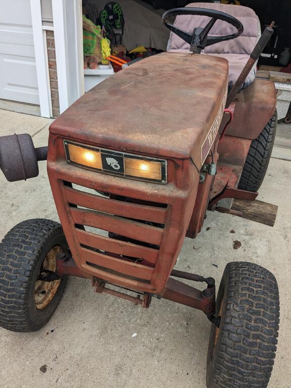

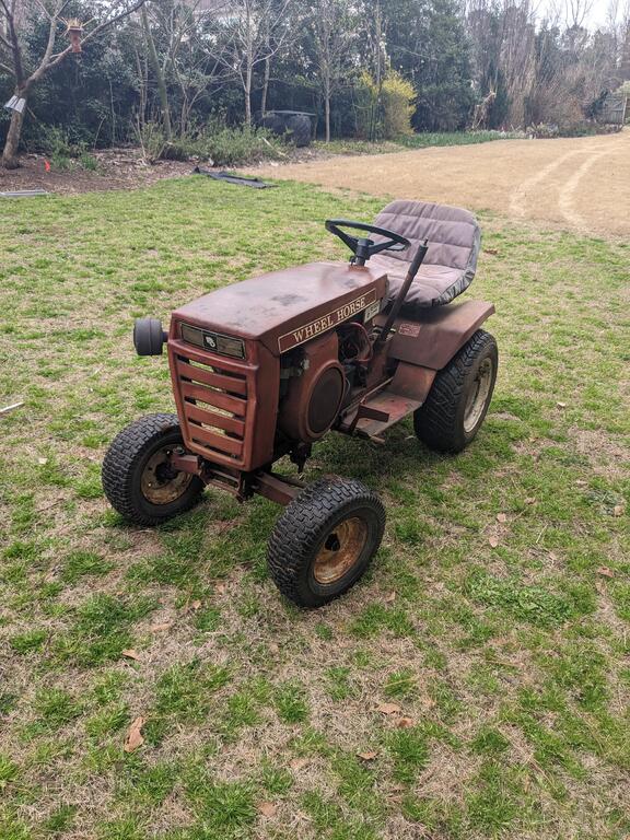

John2189 599 #38 Posted March 3, 2023 (edited) On 2/21/2023 at 1:14 PM, Treepep said: Well,. New to me. We finally got together on price. Now I have a breeding pair. Eight years difference shouldn't matter 😉 In the first picture, I wonder what they used that conduit clamp for? Nice tractor. Edited March 3, 2023 by John2189 1 Share this post Link to post Share on other sites
TractorEd 675 #39 Posted March 3, 2023 (edited) 26 minutes ago, John2189 said: I wonder what they used that conduit clamp for? Probably to hold the Mr. Microphone for cat-calling passers-by. ”Hey! I’ll be back to pick you up later!” Edited March 3, 2023 by TractorEd Share this post Link to post Share on other sites
953 nut 68,194 #40 Posted March 3, 2023 36 minutes ago, John2189 said: I wonder what they used that conduit clamp for? Drink holder for those itty bitty liquor bottles they gave away on airliners years ago. 2 2 Share this post Link to post Share on other sites
John2189 599 #41 Posted March 3, 2023 10 minutes ago, 953 nut said: Drink holder for those itty bitty liquor bottles they gave away on airliners years ago. I like that idea. 1 Share this post Link to post Share on other sites

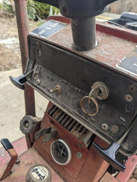

Treepep 1,149 #42 Posted March 4, 2023 11 hours ago, John2189 said: In the first picture, I wonder what they used that conduit clamp for? Nice tractor. Good eye. I had the same thought. Cigar holder whilst mowing. Such a small space...umm...mini driver for carb adjustment. I am not sure Share this post Link to post Share on other sites
Treepep 1,149 #43 Posted March 22, 2023 On 3/3/2023 at 8:49 AM, John2189 said: I like that idea. The clutch safety and the P.T.O safety need replacing. Probably not a huge deal and hopefully available? I am guessing the clamp held a small screwdriver so that one could turn the key and cross the solenoid. I have them defeated with fuses at the moment until I can acquire parts. Thanks guys, Happy horsing! Share this post Link to post Share on other sites
