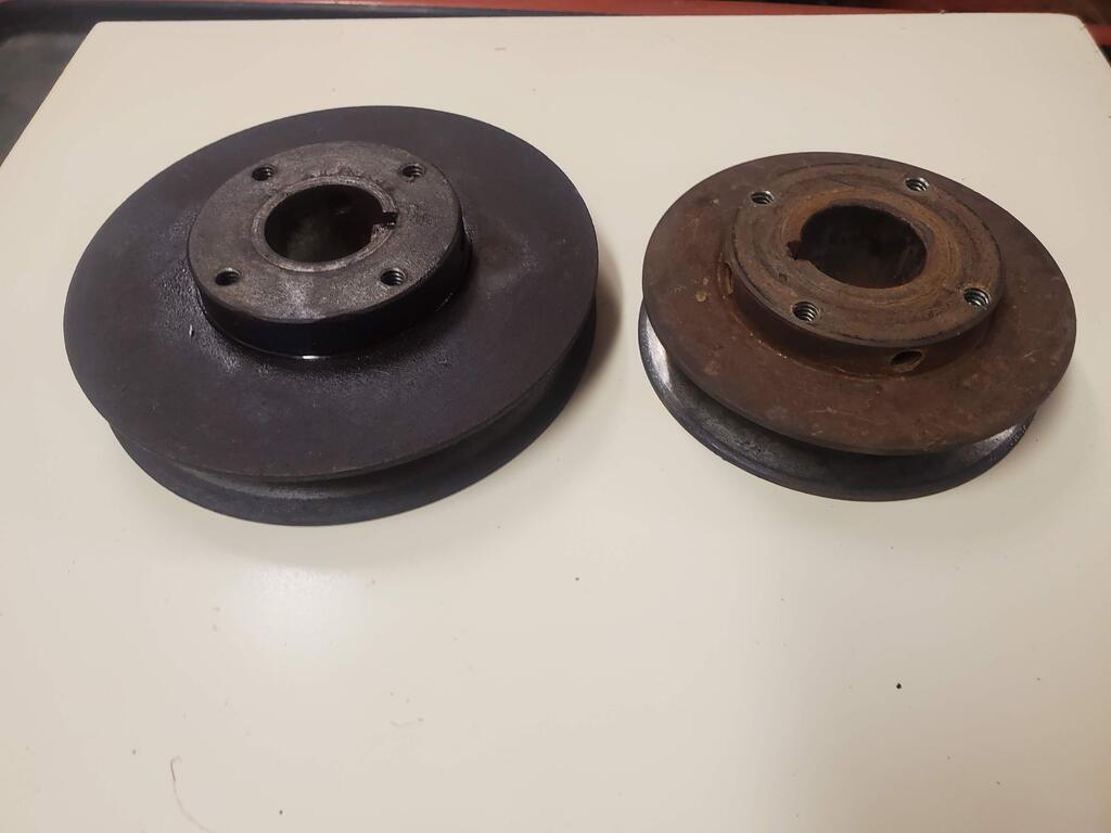

BESTDOGEVER 218 #4 Posted November 30, 2022 Usually the main engine pulley is ddifferent which will change the drive belt size. Using the original pulley should keep everything the same 6 Share this post Link to post Share on other sites

953 nut 62,868 #7 Posted November 30, 2022 If the ignition systems are both battery powered with points and a coil there will be some slight wiring and choke/throttle cable changes, As already mentioned the pulley on the engine of a Hydro tractor is larger than on an 8 eight speed. You would be able to use your pulley from the present engine on the replacement. 1 Share this post Link to post Share on other sites

Alex175 784 #17 Posted November 30, 2022 16 hours ago, BESTDOGEVER said: Usually the main engine pulley is different This is correct, I just recently took a KT17 out of a 417-8 to replace the KT17 in my C-175 Hydro, got really confused when the belt looked way too long after the swap, turned out it was all in the size of the pulley. 2 Share this post Link to post Share on other sites

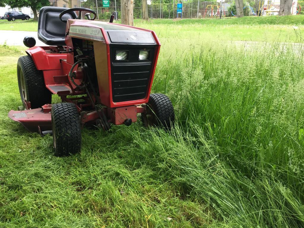

SylvanLakeWH 29,734 #19 Posted November 30, 2022 10 hp cuts through this no problem... 1st gear high. Just my 5 1 Share this post Link to post Share on other sites
