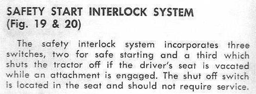

gwest_ca-(File Mod) 11,982 #6 Posted November 29, 2022 No seat switch in the 1975 illustrated parts list so wonder if it was considered part of the seat. It is in the wiring diagrams. 1976-77 no seat switch in wiring diagrams. Found this in the 1976 B&C 8-speed operator manual. See no mention is the 1977 operator manual. 4 Share this post Link to post Share on other sites
