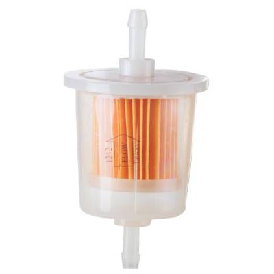

squonk 48,000 #406 Posted February 14, 2024 46 minutes ago, ebinmaine said: Thanks for sharing that video. I took a look at it today. I was trying to hone in on the part number of the ones he was having trouble with. Looks like it may have been something to do with 120-136? The ones we have here are a bag of the Stens brand.. Those filters are sold by many different vendors. I see them all the time sold at flea markets and tractor shows. They have a distinct shape. The Napa # used to be 3011. I had trouble with those. But I see they have changed the design. The old 3011 looked like this: The new 3011 looks like this: 1 Share this post Link to post Share on other sites
