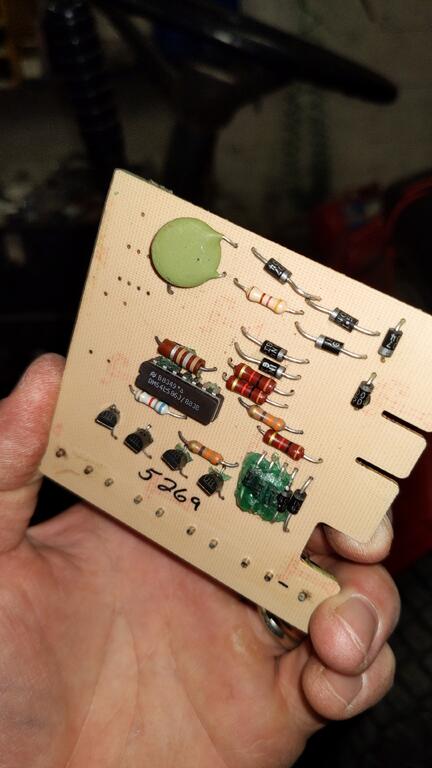

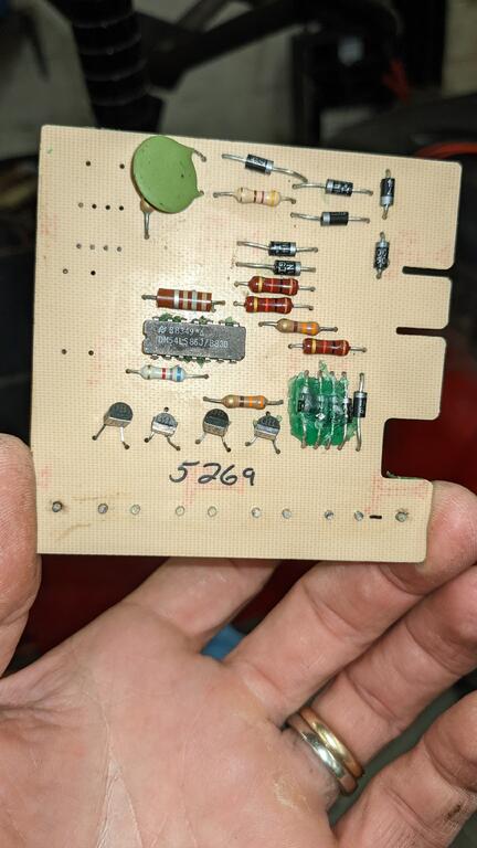

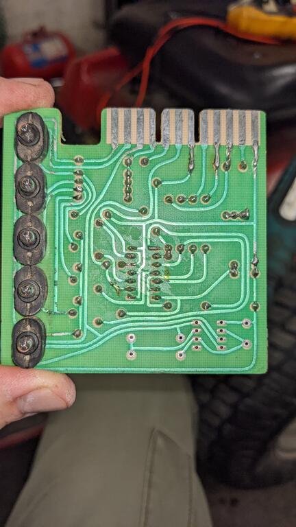

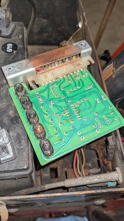

aloe 24 #43 Posted November 28, 2022 So I cleaned up the test switch board and it looks like this... However as soon as I plug it in the PTO light comes on 1 Share this post Link to post Share on other sites
Jeff-C175 7,209 #44 Posted November 28, 2022 (edited) 25 minutes ago, aloe said: cleaned up the test switch board and it looks like this Good job... but the corrosion around the pins and probably under the integrated circuit (IC) is not good. Those ICs are sensitive to static electricity and such... it's fairly likely that the IC is NFG. I wish there was a schematic for that board available. Couldn't find one in the files section, and nobody replied to my query if one is available. I could reverse engineer it, draw a diagram, and repair it ... if it were mine and it was in my hand. ... EDIT: Need to do more looking, but it appears that the 54LS86 may be no longer available, or VERY high cost... I found a substitute that would work, and there is still stock around, so it could be repaired. Edited November 28, 2022 by Jeff-C175 1 Share this post Link to post Share on other sites
aloe 24 #45 Posted November 28, 2022 No I don't think that's corrosion that's just the green silicone mat that I couldn't remove 1 Share this post Link to post Share on other sites
aloe 24 #46 Posted November 28, 2022 (edited) I have a brand new battery so what I'm going to do is just see if there's any voltage drain with it sitting without the PC board plugged in Edited November 28, 2022 by aloe 1 1 Share this post Link to post Share on other sites
Jeff-C175 7,209 #47 Posted November 28, 2022 2 hours ago, aloe said: don't think that's corrosion Ok, good! 2 hours ago, aloe said: see if there's any voltage drain with it sitting without the PC board plugged in That should tell you a lot. Share this post Link to post Share on other sites
Jayzauto 89 #48 Posted November 28, 2022 If you invest in a DVOM, use the amps circuit, and you'll know Immediately IF there is in fact a "Draw". You can also confirm Charging Voltage and Current. Monitor battery Voltage while cranking for 15 seconds will simulate a "Load Test". All these tests can be run in under 5 minutes and Will point to a deficiency in the electrical system. *NOTE: I am neither an electrical engineer, mechanical engineer, or Any type of engineer, Nor do I play one on TV... These are simply lessons I've Learned from The School Of Hard Knocks. GLuck, Jay 2 Share this post Link to post Share on other sites
aloe 24 #49 Posted November 28, 2022 OK - so after the night... with the PC board unplugged, no draw down on battery. So....that points to some fault in PC board/indicator lights being the culprit?? But why is there power to the PC board in the first place? 2 Share this post Link to post Share on other sites
gwest_ca-(File Mod) 12,416 #50 Posted November 28, 2022 PC board is wired directly to the battery. 1 Share this post Link to post Share on other sites
