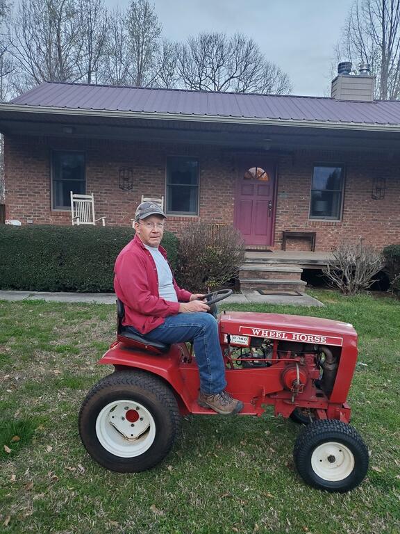

GAJoe 852 #183 Posted March 12, 2023 Finally got the seal in and all back together. 2 2 Share this post Link to post Share on other sites
Horse Newbie 7,405 #184 Posted March 12, 2023 Looks like it paid off to keep it and wrench on it… great looking machine ! 4 Share this post Link to post Share on other sites
OutdoorEnvy 1,817 #185 Posted March 12, 2023 Yeah that rig is nice! Glad you put the time in. Hope you get lots of use with it 3 Share this post Link to post Share on other sites
GAJoe 852 #186 Posted March 12, 2023 I should have bought stock in a bearing distributor. But I'm glad that it can be serviced and repaired for it's age. 2 Share this post Link to post Share on other sites
