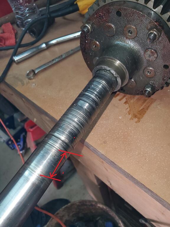

Horse Newbie 7,405 #152 Posted December 17, 2022 10 hours ago, GAJoe said: I just have to say that the Evapo-Rust performed excellent for removing the rust. Look at the before and after with no elbow grease what-so-ever. Looks like it also removed the scoring on the axle, or is that a new axle ? 2 Share this post Link to post Share on other sites
GAJoe 852 #153 Posted December 17, 2022 42 minutes ago, Horse Newbie said: Looks like it also removed the scoring on the axle, or is that a new axle ? New axle 1 Share this post Link to post Share on other sites

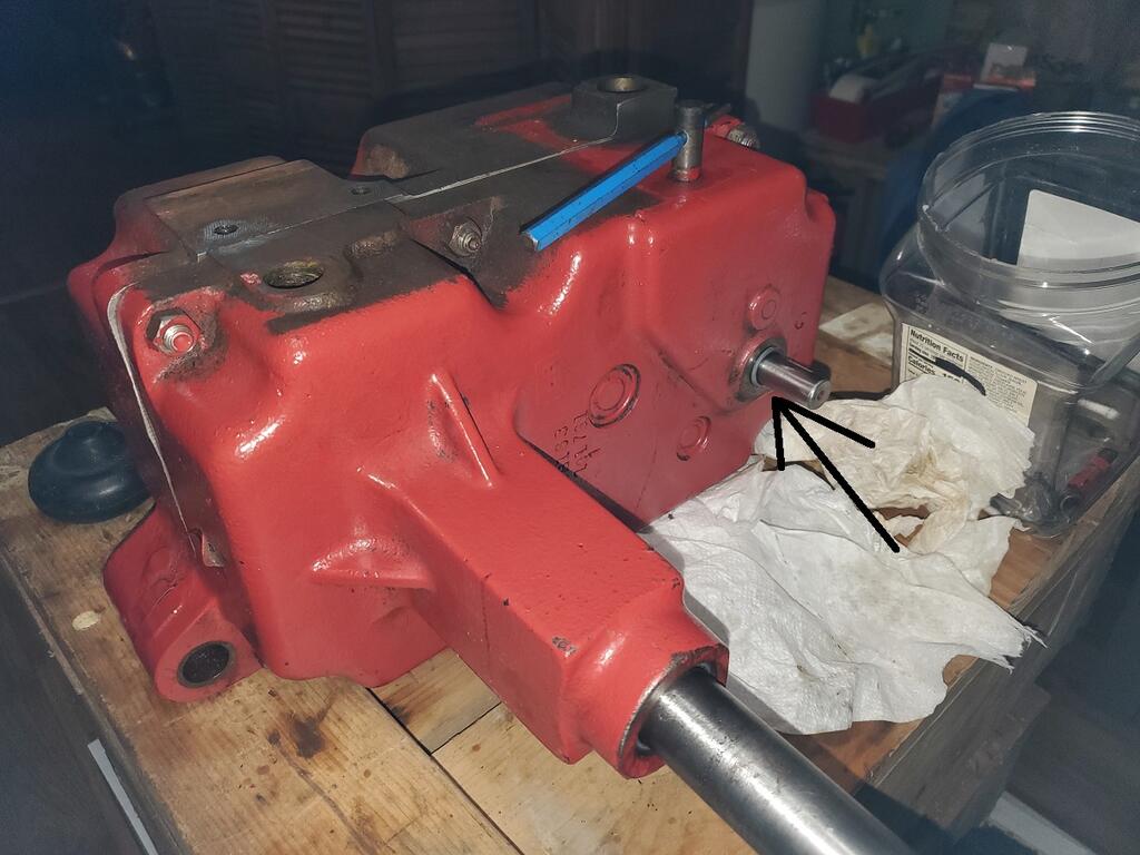

GAJoe 852 #154 Posted December 17, 2022 (edited) Got the tranny back together! WHAT SHOULD THE BOLTS BE TORQUED TO? I know that I have seen or heard that number some where; just cant remember. I should have writter it down. And got the seals in except for the input shaft seal. Can anyone recommend a common pipe, cylinder, or something to set it? Edited December 17, 2022 by GAJoe ask a question 1 2 1 Share this post Link to post Share on other sites
ebinmaine 81,289 #155 Posted December 17, 2022 (edited) 20 hours ago, GAJoe said: got the seals in except for the input shaft seal. Can anyone recommend a common pipe, cylinder, or something to set it? For the seals to be set on a Wheelhorse transmission you can actually use the item that sets in front of them to drive them because the seals set flush to the outside of the transmission case. The input seal can be started carefully like the others by hand then driven into place by using the input drive pulley as the seal driver. Torque specs on that are the industry standard. 3/8 course thread grade 5. Likely around 22 to 25 lb ft. I always go on the tight side of that. Edited December 18, 2022 by ebinmaine Correct autocorrect 2 1 Share this post Link to post Share on other sites
rick 328 #156 Posted December 17, 2022 It might be possible to use the input pulley sliding on the shaft to tap the seal in. I've never done that seal though so it's just a guess. 1 Share this post Link to post Share on other sites
rick 328 #157 Posted December 17, 2022 Go beat, lol 1 Share this post Link to post Share on other sites

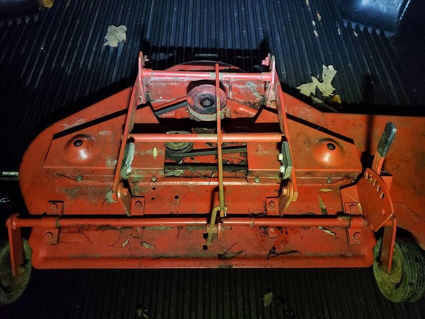

GAJoe 852 #158 Posted December 18, 2022 Well I messed the input seal up; gonna order a couple more. But I thought I'd get new belts in the same order. Is there a guide to selecting belts? I found the number "7473" on the original drive belt and will get the same. What part # is the belt that goes through the Mule to power the deck? It was dry rotted and I wound up cutting it off. It was right at 100" long if that helps. Also my 36" mowing deck needs the drive belt replaced; part #? 2 Share this post Link to post Share on other sites
ebinmaine 81,289 #159 Posted December 18, 2022 2 minutes ago, GAJoe said: Well I messed the input seal up; gonna order a couple more. But I thought I'd get new belts in the same order. Is there a guide to selecting belts? I found the number "7473" on the original drive belt and will get the same. What part # is the belt that goes through the Mule to power the deck? It was dry rotted and I wound up cutting it off. It was right at 100" long if that helps. Also my 36" mowing deck needs the drive belt replaced; part #? I've gotten into the habit of ordering an extra of most every seal I change. If the first one goes in right I keep the spare in stock for the next tractor need. For the drive belt... Seriously... Save yourself a BUNCH of time and get a Wheelhorse brand belt. The length needs to be just right along with the angle. Wheelhorse Parts and More has them along with several other sources. 1 Share this post Link to post Share on other sites
GAJoe 852 #160 Posted December 18, 2022 (edited) 18 minutes ago, ebinmaine said: I've gotten into the habit of ordering an extra of most every seal I change. If the first one goes in right I keep the spare in stock for the next tractor need. For the drive belt... Seriously... Save yourself a BUNCH of time and get a Wheelhorse brand belt. The length needs to be just right along with the angle. Wheelhorse Parts and More has them along with several other sources. I did and messed both up; ordering 2 again. I was planning on getting the belts from them also. Can they help pick the belt sizes? Edited December 18, 2022 by GAJoe 2 Share this post Link to post Share on other sites
ebinmaine 81,289 #161 Posted December 18, 2022 1 hour ago, GAJoe said: I did and messed both up; ordering 2 again. I was planning on getting the belts from them also. Can they help pick the belt sizes? Remind me of the tractor model number? 1 Share this post Link to post Share on other sites
Horse Newbie 7,405 #162 Posted December 18, 2022 2 hours ago, GAJoe said: Well I messed the input seal up I messed up 2 before I got one in… someone on here recommended installing it backwards, so I did. The problem I had was the edge of the metal part of the seal would catch on the transmission case. Mine is working fine backwards and besides, the oil level barely gets that high anyways… 2 1 Share this post Link to post Share on other sites

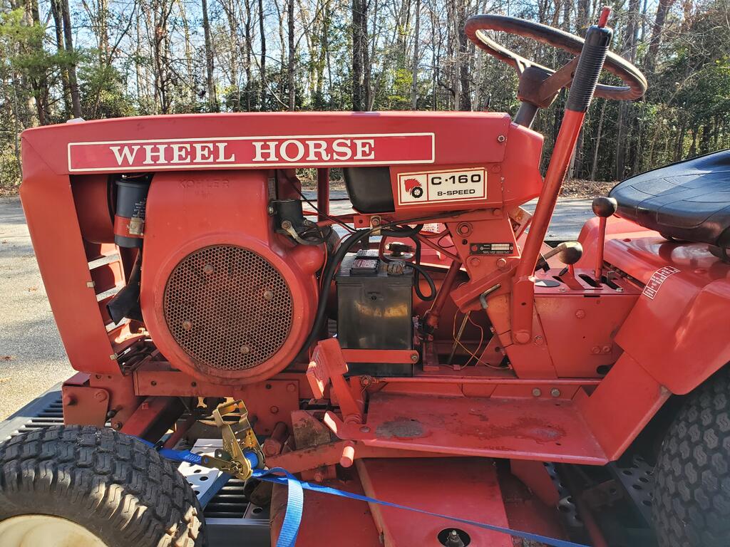

GAJoe 852 #163 Posted December 18, 2022 (edited) 5 hours ago, ebinmaine said: Remind me of the tractor model number? a C-160 M# 1-0380 The 36" deck that I found came from a B-80 and the tag has been painted over. I can cut and measure that belt if that's the easiest way to get the size. Edited December 18, 2022 by GAJoe added info 1 Share this post Link to post Share on other sites
ebinmaine 81,289 #164 Posted December 18, 2022 The tractor drive belt is the 7473. The others someone else will be along to help out. 1 Share this post Link to post Share on other sites
953 nut 70,666 #165 Posted December 18, 2022 20 hours ago, GAJoe said: WHAT SHOULD THE BOLTS BE TORQUED TO? 30 foot pounds, that goes for the differential bolts to. 9 hours ago, GAJoe said: Is there a guide to selecting belts? 1 1 Share this post Link to post Share on other sites

Horse Newbie 7,405 #169 Posted December 18, 2022 (edited) 11 hours ago, GAJoe said: I can cut and measure that belt if that's the easiest way to get the size You DONT HAVE to cut it… make a mark on it with a Sharpie… put the marked area of the belt on the floor… make a mark on the floor. Roll the belt on the floor until the spot you marked comes back around. Make another mark on the floor… now measure the distance between the marks with a tape measure…Walla ! Or… you could just start the mark at zero, then roll the belt beside a tape measure. See how many inches it says when you reach the mark again… Edited December 18, 2022 by Horse Newbie 1 2 Share this post Link to post Share on other sites

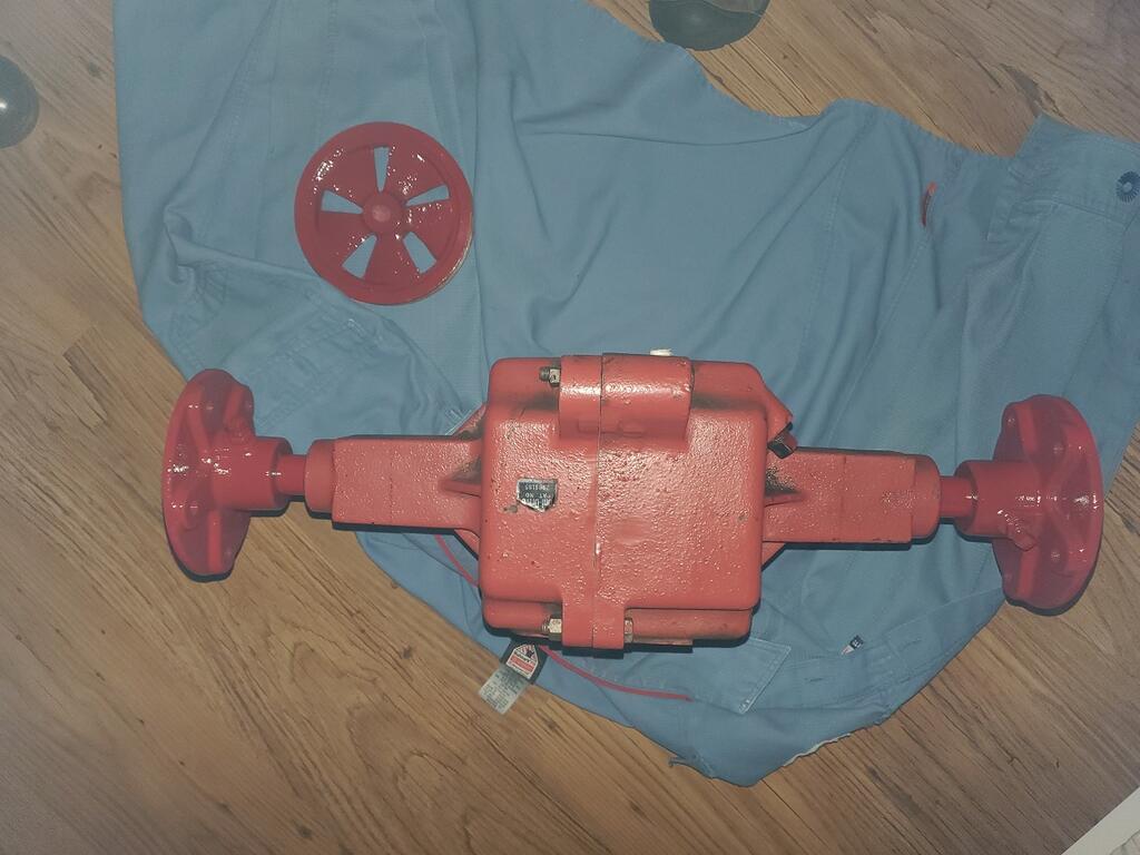

GAJoe 852 #171 Posted December 20, 2022 (edited) The tranny is all back together with hubs painted as close as I could find. It'll look better to me when that glossy paint gets dull. Now what oil should I use down here in North GA? The lowest temps that we see are in the teens. I got Super Tech 80W-90 from someones recommendation but I see that the manual calls for SAE 90-140. What motor oil should I use in the Kohler K341S while we're at it? Edited December 20, 2022 by GAJoe 2 Share this post Link to post Share on other sites
ebinmaine 81,289 #172 Posted December 20, 2022 14 minutes ago, GAJoe said: Now what oil should I use down here in North GA? The lowest temps that we see are in the teens. I got Super Tech 80W-90 from someones recommendation but I see that the manual calls for SAE 90-140. What motor oil should I use in the Kohler K341S while we're at it? These transmissions will use pretty much anything close to 80w. 90w. 80w 140. Whatever is cheap and convenient. For that matter I understand straight 40 engine oil was on e on the menu for the transmission. As to your engine... HD 30 with detergent per the Kohler manual. Brand is a personal preference. Most important? Change it. 1 Share this post Link to post Share on other sites
GAJoe 852 #173 Posted December 28, 2022 On 12/17/2022 at 11:49 PM, Horse Newbie said: I messed up 2 before I got one in… someone on here recommended installing it backwards, so I did. The problem I had was the edge of the metal part of the seal would catch on the transmission case. Mine is working fine backwards and besides, the oil level barely gets that high anyways… The two from Lowell got held up on back-order. I found where Steve gave the SKF# some where and ordered one from Amazon. I used the input pully and even chamfered the rubber lip off to make sure it wasn't holding the edge out. It started and went in except where the key-way was on the input pulley. Messed up a third one. The next one is goin' in bakards! 1 Share this post Link to post Share on other sites
