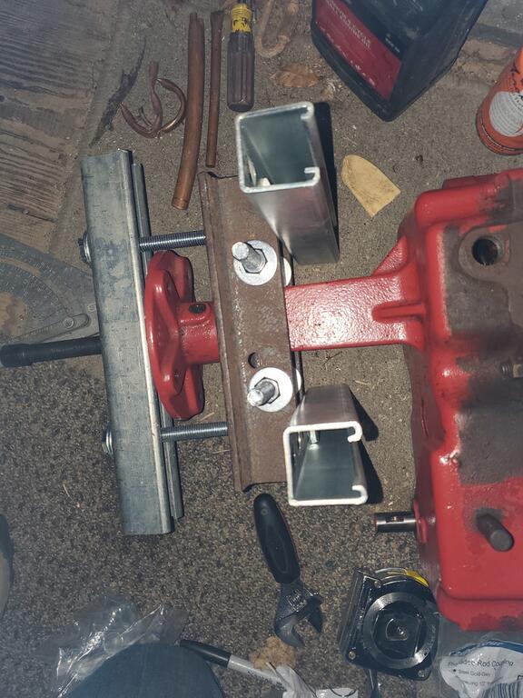

GAJoe 852 #42 Posted November 24, 2022 (edited) Thanks Eric I'll watch tomorrow. I have scheduled with my good friend Shawn to go to his shop on Saturday morning to open it up. Hopfully I'll have the hubs off. I tried tonight but didn't have success. I gave it liberal soaking with Kroil a couple times yesterday. Today I hit it with more kroil and I fabb'ed up my hub puller and then gave it try. Not movin'. (See the pictures; the T-bars are not clamped tight on the shaft. I ground out third circle on the edges on the shaft side to get that web closer to the shaft. Also the hardened steel bar that the hardened steel jacking bold goes through is inside the horizontal unistrut. It wasn't long enough to reach around the hub.) I got out the heat gun (didn't want to ignite the Kroil.) and warmed it up slowly. I didnt get it terribly hot. I tried pulling one more good time until I saw the unistrut begin to bend as I heated. The hub still hasn't moved. I reheated up both hubs hotter than before and left the set screw holes pointing up. I sprayed more Kroil into the keyways and filled the set screw hole up with Kroil. I did a little tapping to see if the Kroil will penetrate a little better. I'll try again in the morning one more time with the unistrut. before trying a beefier puller. I hope those hot hubs allows some better Kroil penetration. We'll see; and I'll let you know. Edited November 24, 2022 by GAJoe 3 1 Share this post Link to post Share on other sites

ebinmaine 81,289 #45 Posted November 24, 2022 Kroil is EXCELLENT. Keep using that. The unistrut... Great idea but very likely not strong enough. The puller you have set up from the back of the hub should work just fine. See about replacing the unistrut with 2 more pieces of the much thicker metal. Heat is your friend. You won't over heat anything in there with a propane torch and should actually be using something hotter if possible. You can heat the hub right to red then wait maybe 5 minutes? Spray the kroil in while still quite toasty. As the oil is cooling the pieces it's also penetrating further in to more expanded areas. Heat. Oil. Repeat. Repeat. Repeat. etc... Again..... Do NOT use a hammer no matter how long it takes. ALL parts are available for these 8 speed transmissions. Hubs in good used form are $40-ish give or take, each. New aftermarket ones are also available for just over 100 bucks. I believe once you strengthen your puller your hubs will be removable and usable. 2 Share this post Link to post Share on other sites
Horse Newbie 7,405 #47 Posted November 24, 2022 (edited) 1 hour ago, ebinmaine said: Do NOT use a hammer Why can’t you use a hammer ?… break hub, damage transmission internals, or both ? Now I know you would not want to wail on it- I’m talking about a little persuasion … Edited November 24, 2022 by Horse Newbie 1 Share this post Link to post Share on other sites
pfrederi 21,346 #48 Posted November 24, 2022 Both !! 2 Share this post Link to post Share on other sites
ebinmaine 81,289 #49 Posted November 24, 2022 5 minutes ago, Horse Newbie said: Why can’t you use a hammer ?… break hub, damage transmission internals, or both ? Now I know you would not want to wail on it- I’m talking about a little persuasion … 3 minutes ago, pfrederi said: Both !! It's definitely both. Yes. The most susceptible part is the axle lock ring inside the differential. "A little persuasion" is a good term but unfortunately is grossly incorrectly interpreted by some (including myself) so it's best to say NO hammer. 1 1 Share this post Link to post Share on other sites
