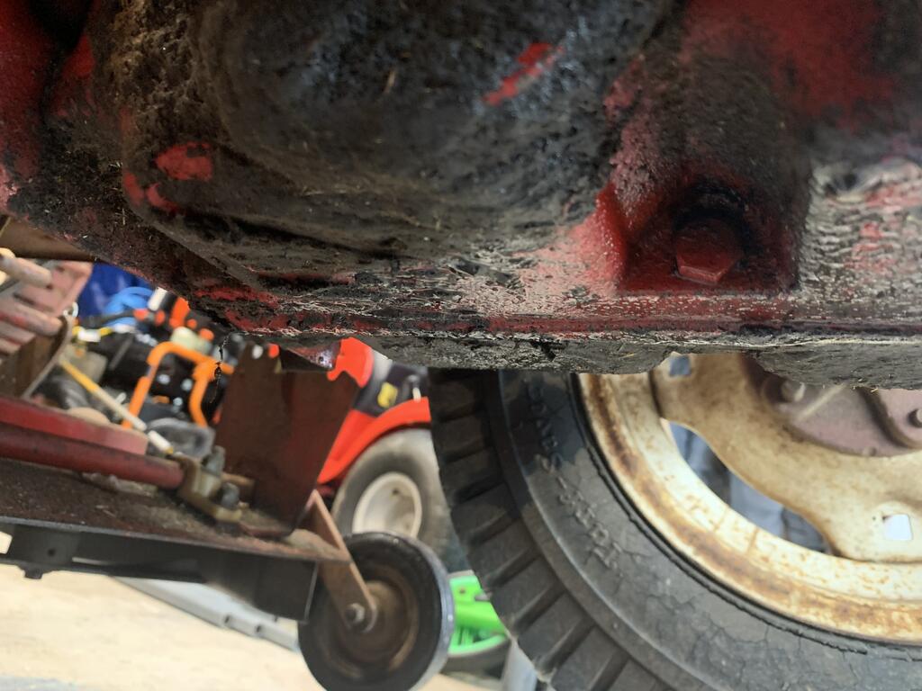

Jake Wilkerson 38 #1 Posted November 19, 2022 (edited) First hydro horse I’ve had. Had original filter and not showing any paint removed from the drain bolt. Safe to assume it hasn’t been touched in 52 years. anything to know? I topped it off with Valvoline Dex/Merc ATF and run it around a little bit. Was working fine before but it was 3.5 qts low. Surprised it’s survived this long. Have a couple Napa 1410s on order and 2 more gallons of ATF coming UPDATE : Figured out that wasn’t the drain plug. Original statement still stands that it’s never been serviced though. Letting it throughly drain and going to fill it up with fresh fluid. Not seeing a whole lot of metal or contamination but the fluid was a burnt orange color. Dipstick was extremely corroded. Hoping for the best. Edited November 19, 2022 by asleepz 3 Share this post Link to post Share on other sites

Jake Wilkerson 38 #3 Posted November 19, 2022 After what I found I’m surprised it was doing as well as it was, she runs nearly silent as well. Hoping I caught it just in time to prevent catastrophic failure 2 1 Share this post Link to post Share on other sites
