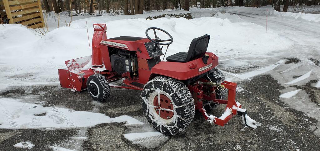

Alex175 784 #4 Posted November 18, 2022 (edited) 11 hours ago, gwest_ca said: They may be the same except for the lift tube and flag. Exactly what Garry said, you can use the snowblowers on the C-195, but there is a different length lift rod. For the C-195 the rod isn't separate from the flag, they are all one unit, welded together. Additionally it requires a different size belt, but I ran a tall chute blower on my C-195 last year and it worked fantastically, plenty of power to launch that snow. I only wish that the two stage blowers could be properly mounted on the C series. Edited November 18, 2022 by Alex175 added photo 1 Share this post Link to post Share on other sites
