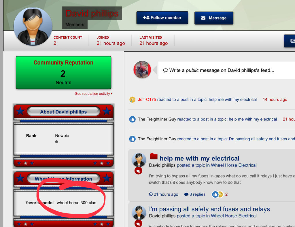

Pullstart 68,524 #7 Posted November 15, 2022 My guess is the 300 series in his profile Share this post Link to post Share on other sites
lynnmor 8,254 #8 Posted November 15, 2022 42 minutes ago, Pullstart said: My guess is the 300 series in his profile Just look at the mess in his other post. Share this post Link to post Share on other sites
