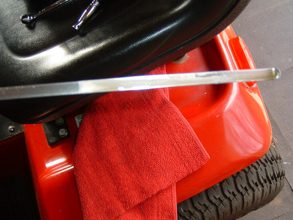

Dennis C. 142 #42 Posted November 15, 2022 OK all, here is the picture of the dipstick taken 10 minutes ago after running 15 minutes at 1/2 throttle. I installed a new plug, correctly gaped, adjusted the Walbro carb according to the manual. Engine is warming up now after 10 minutes. Currently draining the oil and will replace with 5-30 wt and see what happens next. 2 1 Share this post Link to post Share on other sites

lynnmor 9,013 #44 Posted November 15, 2022 Looks like your water is condensing on the relatively cold dipstick. Again, check your breather. Running an engine at half throttle with no load won't build much heat. When you drain motor oil, do it hot and have your tools ready then drain immediately after shutting down. 3 1 Share this post Link to post Share on other sites
Snoopy11 5,731 #45 Posted November 15, 2022 3 minutes ago, lynnmor said: Running an engine at half throttle with no load won't build much heat. Absolutely correct. Full throttle all the way. If it's a mowing machine, engage PTO. Don 1 Share this post Link to post Share on other sites
