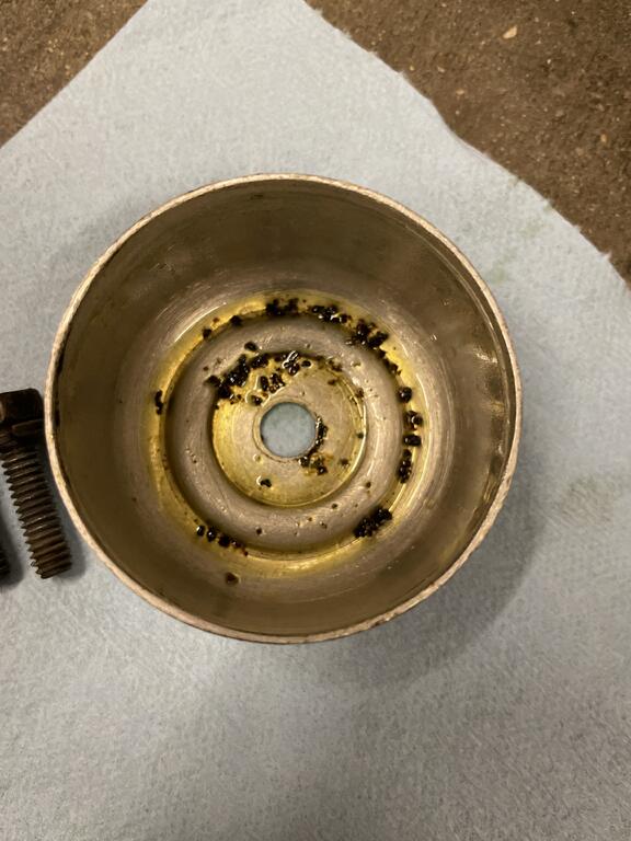

Bow_Extreme 578 #1 Posted November 13, 2022 A little surprise in the carb. Guessing the filters are decayed, slightly…… 12 Horse Magnum 3 Share this post Link to post Share on other sites
ebinmaine 74,572 #2 Posted November 13, 2022 Got you some ethanol effects there. Dissolving a rubber fuel line maybe? 2 Share this post Link to post Share on other sites

Handy Don 14,658 #4 Posted November 13, 2022 49 minutes ago, Bow_Extreme said: A little surprise in the carb. Guessing the filters are decayed, slightly…… 12 Horse Magnum Filter would have to be extremely ruined for particles of that size to get through. Deteriorating fuel line between filter and carb is more likely. 2 Share this post Link to post Share on other sites
Bow_Extreme 578 #5 Posted November 13, 2022 6 minutes ago, ebinmaine said: Got you some ethanol effects there. Dissolving a rubber fuel line maybe? Agreed. Just a little PM work on a Weekend. 1 Share this post Link to post Share on other sites
Bow_Extreme 578 #6 Posted November 13, 2022 1 minute ago, Handy Don said: Filter would have to be extremely ruined for particles of that size to get through. Deteriorating fuel line between filter and carb is more likely. Tank will be removed and cleaned, new fuel lines, filter, carb rebuild, and reassemble. 👍 1 1 Share this post Link to post Share on other sites

Sailman 1,304 #8 Posted November 14, 2022 Run ONLY non-ethanol gas. Costs more but absolutely essential in all small motors! Garden Tractors, weed eaters, leaf blowers, dirt bikes, outboard motors, etc...... 1 Share this post Link to post Share on other sites
Bow_Extreme 578 #9 Posted November 14, 2022 6 minutes ago, Sailman said: Run ONLY non-ethanol gas. Costs more but absolutely essential in all small motors! Garden Tractors, weed eaters, leaf blowers, dirt bikes, outboard motors, etc...... That is all I run. This is a unit I picked up a couple weeks ago. It wouldn’t start right away and it only ran on full choke. Thus why the owner decided to part with it and buy a cheap Husqvarna to replace it. 1 Share this post Link to post Share on other sites
