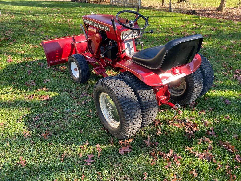

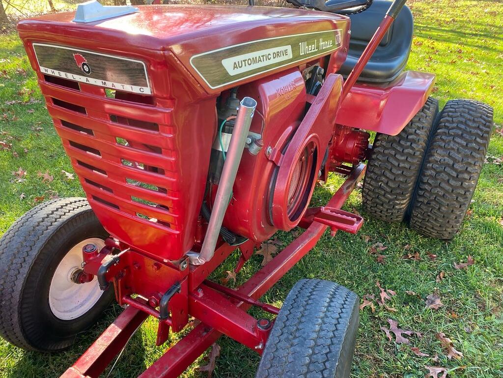

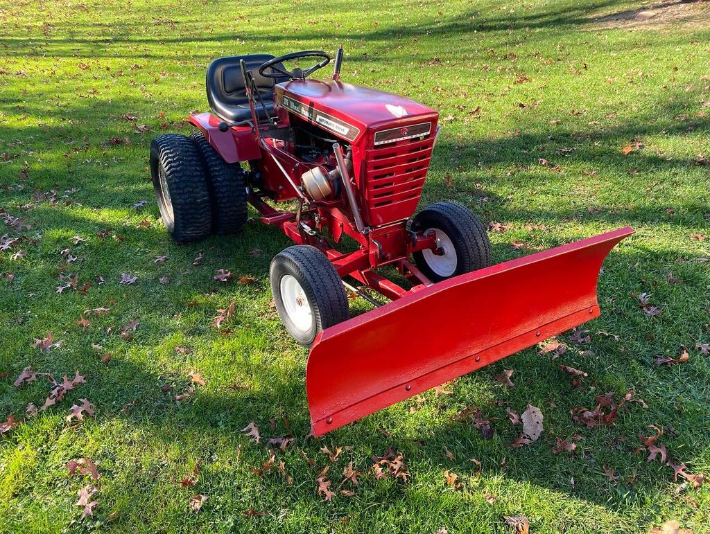

Thompson1276 257 #1 Posted November 9, 2022 Just had 4 sets of Sears branded 12’ inch wheels and decided why not dually it , for a minute I was onna dually with my freshly painted rears for the horse but the horse has 1’ and 1’ wider and taller tires and the wheels are 1’ narrow with that , but I put a spacer in it and locked em in and put a 75 pound wheel horse rear weight on each wheel between the two wheels and put chrome caps on the end to hide the sears wheels rust but not bad. Also made this HL-5 headlamp bad I still need to gets lights for at harbor freight and run em to the rear light in the back sure I don’t need to take the tank out to get to the control pannel , though sized up and burnt my hand doing it my grabbing pipe red hot I’m fine now , though no finger prints best criminal advantage I guess , for those wondering how I made the bar it Was 5 foot aluminum pipe 1 inch Dia. And was like 1/8 thick and I got my M.A.P. Fuel blow torch and put 2 holes lined up 6 inches across where I was onna bend it , the light part is 16 inches and the middle is 6 , but then blew a hole at 16 inches in and 22 inches in and cut at 28 inches and beng at the holes and lined it up to make it even and then smacked the doled edges flat with a hammer to prevent from moving, then drilled 2 holes at the bottom found some sheet metal plate with squares for 1/4 bolts I ran through and the pipe to hold it in at surplus city in a bucket , then holes at the top 1/2 inch down and then painted it chrome to prevent rust , very solid and works , I’ll post another pic ones lights are on. I’m not a professional at metal bending but I have repaired rust holes with license plates , fiberglass , and bondo . 6 Share this post Link to post Share on other sites
Retired Wrencher 6,442 #2 Posted November 9, 2022 Nice 1276. Did you do the paint or bought it that way? Enjoy the tractor every day. 1 Share this post Link to post Share on other sites
953 nut 64,073 #3 Posted November 9, 2022 8 hours ago, Thompson1276 said: decided why not dually it You will be best off with only a couple pounds of air pressure in the outer pair of tires. If the outer tires go over something higher than the inner tires it will put too much strain on the hub and axle if the outer tire is fully inflated. 4 1 Share this post Link to post Share on other sites

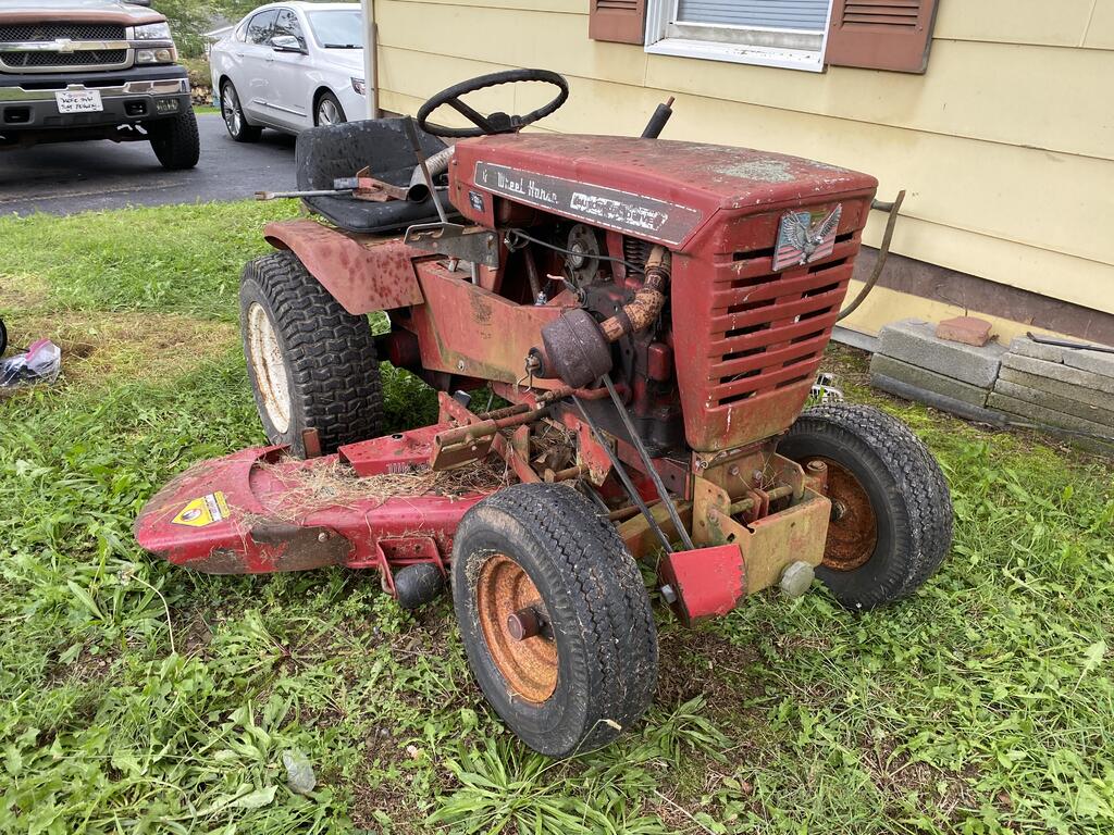

Thompson1276 257 #4 Posted November 9, 2022 2 hours ago, Retired Wrencher said: Nice 1276. Did you do the paint or bought it that way? Enjoy the tractor every day. I painted it and did all the work myself all the work I did by starting from a dirty but clean plate 2 Share this post Link to post Share on other sites
Thompson1276 257 #5 Posted November 9, 2022 1 hour ago, 953 nut said: You will be best off with only a couple pounds of air pressure in the outer pair of tires. If the outer tires go over something higher than the inner tires it will put too much strain on the hub and axle if the outer tire is fully inflated. Will do thank you 1 Share this post Link to post Share on other sites

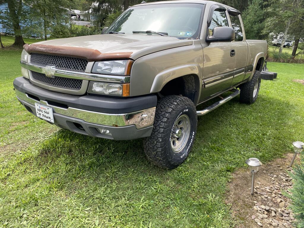

Jeff-C175 7,207 #6 Posted November 9, 2022 This is camera lens distortion, right? You don't really have that much negative camber on the PU truck, do you? 1 1 Share this post Link to post Share on other sites

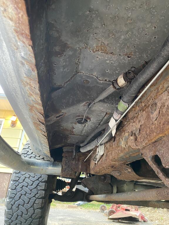

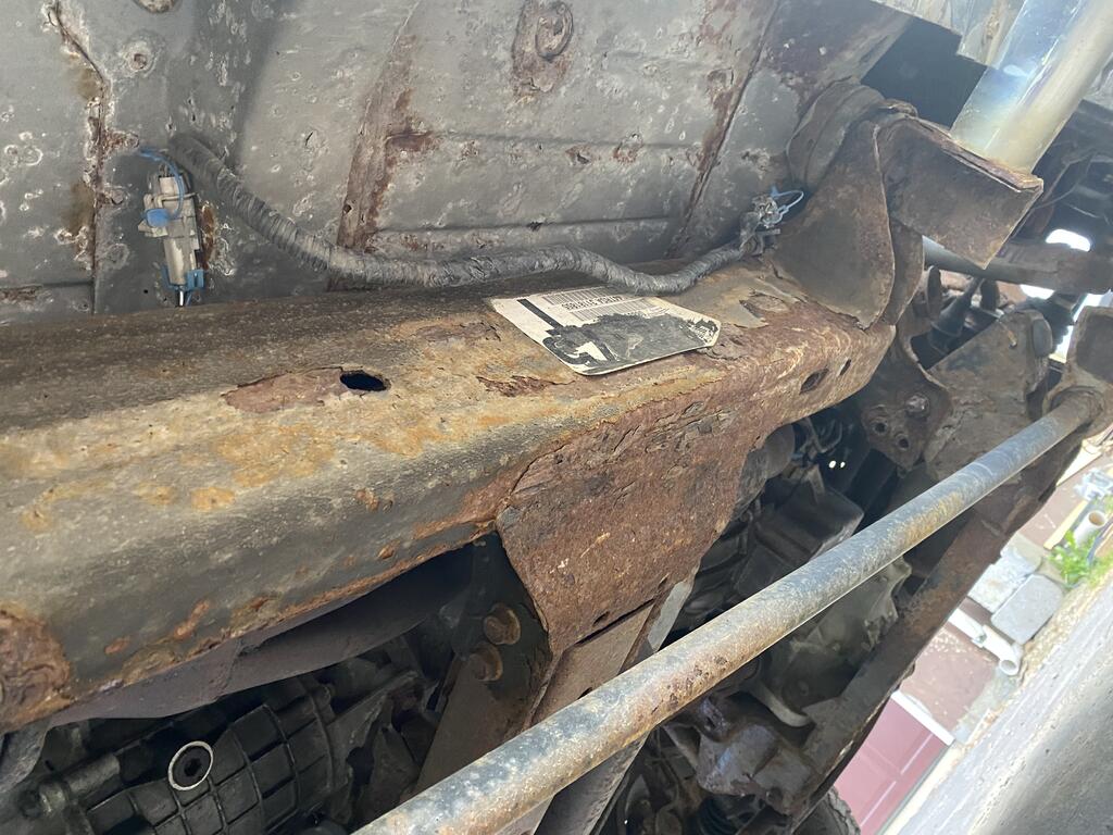

Thompson1276 257 #7 Posted November 9, 2022 17 minutes ago, Jeff-C175 said: This is camera lens distortion, right? You don't really have that much negative camber on the PU truck, do you? It’s rotted out I need to fix it sat for 5 years 1 Share this post Link to post Share on other sites

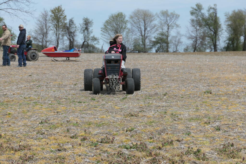

Pullstart 68,848 #9 Posted November 9, 2022 5 hours ago, Thompson1276 said: Will do thank you My dually has nail holes in the outer tires. ZERO pressure. Same with my super fat tire “Poppy” 3 Share this post Link to post Share on other sites
Jeff-C175 7,207 #10 Posted November 9, 2022 5 hours ago, Thompson1276 said: It’s rotted out Looks good from here! Share this post Link to post Share on other sites

Thompson1276 257 #15 Posted November 9, 2022 1 hour ago, Jeff-C175 said: Looks good from here! It doesn’t look bad but it won’t pass inspection I’m still trying to find a way to maybe restore it again , the truck is all original was off the show room floor with the lift and stuff in 2002 , the frame on this has a recall for lack of anti rust compound not added on but chevys solution to this recall was spray it on after if you knew about the recall and your truck isn’t rusted out so I never knew till it was too late and I can’t just get a new frame but I’ll find a way since the body and cab is like new , it only has 82,000 miles and has a fresh well taken care of 5.3 Vortec 1 1 Share this post Link to post Share on other sites

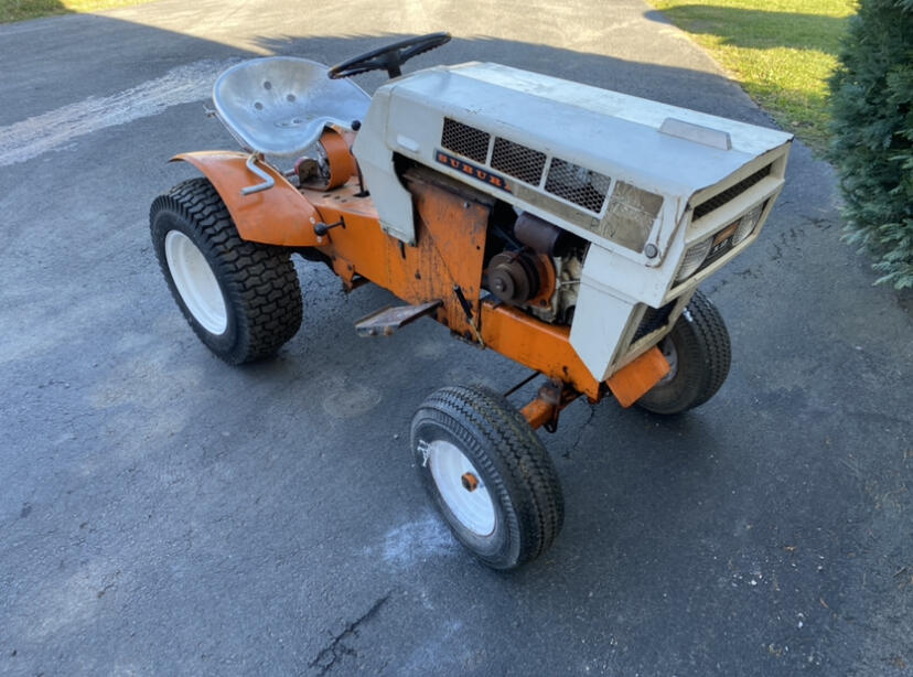

Thompson1276 257 #16 Posted November 9, 2022 4 hours ago, Pullstart said: My dually has nail holes in the outer tires. ZERO pressure. Same with my super fat tire “Poppy” Crawler huh? That’s actually sick as hell I have a sears suburban 12 I been wanting to make a crawler I have wheel horse rears tires on the thing can do anywhere and the engine will last forever but the lack of a fuel pump makes it shut off at high inclines and the carb sucks ass since it’s a tecumseh the lack of torque makes it struggle to go up a hill in 3rd hi , but in Lo gears it’ll go anywhere it’s just too slow , too bad there isn’t anywhere here with hella rocks and **** or parks i was onna restore it but I made it a pull start since I can’t find ANY battery that fits it far batterys are too wide and UH1 batterys are too high and the battery for it they don’t make anymore and whatever , so I might keep it stock looking but make it go offroad or pull since it can pop willies in the air just letting go in 3rd hi without trying like at all , but idk maybe put a Koehler in it or something but I’d still need a battery to fit and it would be pull start and I know pull starting a k301 is hard as <censored> compared to a tecumseh Share this post Link to post Share on other sites
Pullstart 68,848 #17 Posted November 9, 2022 8 minutes ago, Thompson1276 said: It doesn’t look bad but it won’t pass inspection I’m still trying to find a way to maybe restore it again , the truck is all original was off the show room floor with the lift and stuff in 2002 , the frame on this has a recall for lack of anti rust compound not added on but chevys solution to this recall was spray it on after if you knew about the recall and your truck isn’t rusted out so I never knew till it was too late and I can’t just get a new frame but I’ll find a way since the body and cab is like new , it only has 82,000 miles and has a fresh well taken care of 5.3 Vortec I’d love to know more about that recall… my ‘99 1500 has 87k on it and the frame is pretty bad…. Feel free to PM me if you’d like instead of clutter your awesome tractor thread 1 Share this post Link to post Share on other sites
Thompson1276 257 #18 Posted November 10, 2022 46 minutes ago, Pullstart said: I’d love to know more about that recall… my ‘99 1500 has 87k on it and the frame is pretty bad…. Feel free to PM me if you’d like instead of clutter your awesome tractor thread https://www.vehiclehistory.com/questions/what-is-the-chevy-silverado-frame-recall-about-107620 here you go man and yeah I prob will 1 Share this post Link to post Share on other sites
Retired Wrencher 6,442 #19 Posted November 10, 2022 21 hours ago, Thompson1276 said: I painted it and did all the work myself all the work I did by starting from a dirty but clean plate Dubble Thums up on the retso! In my younger days I did a few, enjoyed it very much. 1 Share this post Link to post Share on other sites
Thompson1276 257 #20 Posted November 13, 2022 On 11/10/2022 at 6:01 AM, Retired Wrencher said: Dubble Thums up on the retso! In my younger days I did a few, enjoyed it very much. Thank you took about a year but it’s all done now all I have to do is sit back and enjoy it 1 Share this post Link to post Share on other sites
