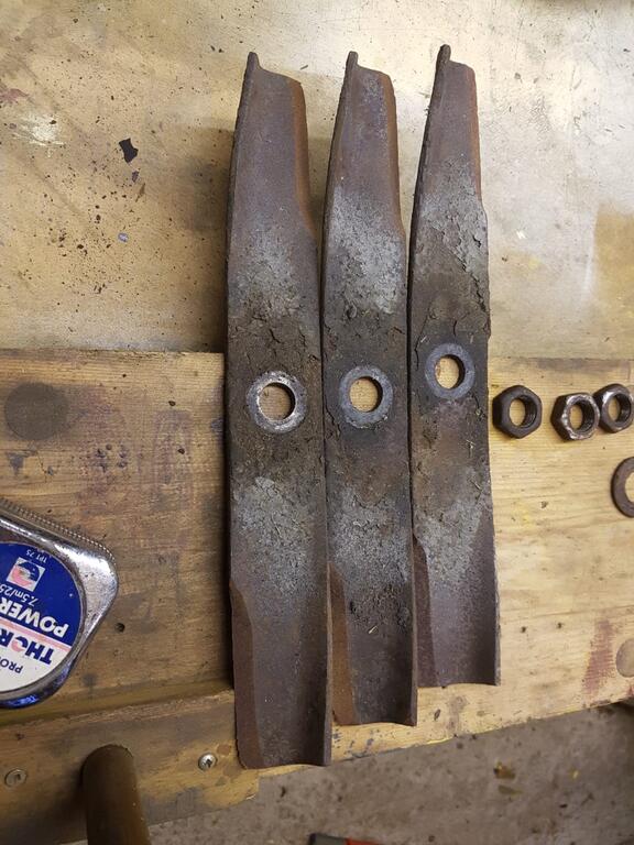

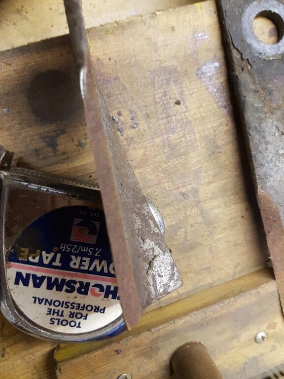

Sutty 100 #34 Posted November 8, 2022 Car started like a champ, after another hour or so on charge. Not a hesitation. Deck not on the bench, who was I kidding. Not a prayer I can get it up there on my own, and no point asking Mrs S to help, lol. It is leaning against it though, and I have the blades off, so I can manage with it there. Blades are all 13-7/8" long, with 3/4" centre holes. Shown below is a typical blade edge. Won't need much doing to them other than the removal of a little grasscrete. It seems amazingly sharp to me. That's looking right down on it, and you can see how good it is. It actually feels sharp to my fingers. As I said, they all measure 13-7/8" in length, with a 3/4" hole, and I have found a replacement mulching blade in stock in the US at least. No luck in the UK yet, but I'm still trying. This is the US one I found, just to check you all agree it's the right thing. I've sent them a message to see if they will ship to the UK, and how much that will cost, in case I get no good responses from the UK suppliers. If they can't, or it's a ludicrous cost, it might be snoopy to the rescue. https://www.agrisupply.com/toro-wheelhorse-mower-blade/p/58033/ If anyone has a better suggestion, US origin or otherwise, I'd be happy to hear about it. Thanks again. Andrew 2 Share this post Link to post Share on other sites

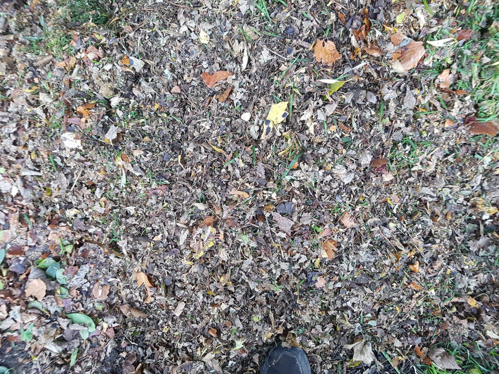

Sutty 100 #37 Posted November 9, 2022 On 11/7/2022 at 5:23 PM, Snoopy11 said: SNIP I have found that... if you mulch the leaves VERY fine before attempting to capture them, they will take up much less room. SNIP Well, this turned out to be the key, but I was a little at a loss as to how to achieve that. Thanks though Don, because those words were still in my head as I rode around. I fitted the wheel horse with the deck and bags, and tried it out. Of course, it worked like a champ, even after not having been run with that set-up for 15 years. I had more difficulty than I would have liked, fitting the deck, but that was just fuzzy memory and I got there in the end. Scooped up 2 lots of double bags of leaves, in that config, running round in a low gear, with high revs, so as to be slow over the ground but have high blade speed. I then did a run round with the cub, taking a similar approach. Very little mulching with either, and I would suggest a similar weight per volume of leaves from them both, with the Wheel horse just having the edge. When I went round with the cub, I overfilled it, and it blocked, but I noticed that in that blocked state it was hacking the leaves into tiny pieces, and shoving them out of the side into lines and I remembered what Don had said. So, instead of emptying it and unblocking it, I left it like that, and ran round the whole lawn I was dealing with, making nice little strips of mulch. I then went to empty it, and unblock it, bit of a pain to do so, but worth it, because, when I returned, I was able to vacuum up all of the strips of mulched leaves, from the front lawn, with a single bag full. Weight per unit volume was way up, using this method. I've taken photographs, of the difference, but not sure how well they will come out. I'll have a look in a minute, and shove them in at the end of this post, whether it's obvious or not. All I need to be able to do is block the chute with some sort of baffle, which will prevent it actually picking up and then remove it to pick up the lines of mulch. I'll have to get my thinking cap on as to how to achieve that, but it will be preferable to having to unblock it. Obviously, mulched and collected in one go would be a big bonus, and if those blades really do that, then it has to be worth getting them, but in their absence, I can manage with a baffle, or even with overfilling it and then unblocking it, until I have the baffle sorted. Wheel horse Cub Cub Mulched A nicely shaped piece of polystyrene jammed into the exit chute might be one quick and dirty method, to stop it picking up. Can't hurt, the worst that could happen is it would burst out and be pushed into the basket. Blocking it at the basket end should be adequate, because if there's no airflow, then it can't pick up to block the chute prior to that, or I wouldn't think so. I'll let you know tomorrow. Thanks all. Cheers Andrew 3 3 Share this post Link to post Share on other sites

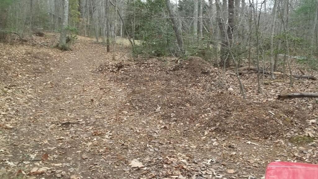

953 nut 67,398 #38 Posted November 11, 2022 (edited) I use a 42" rear discharge deck and a leaf sweeper. This is one of the areas where the composting of ground up leaves begins. They will be turned over a few times this winter and in the spring all three partly composted sites will be combined and piled up to finish. Nothing fancy but it works fine. Edited November 11, 2022 by 953 nut 3 Share this post Link to post Share on other sites

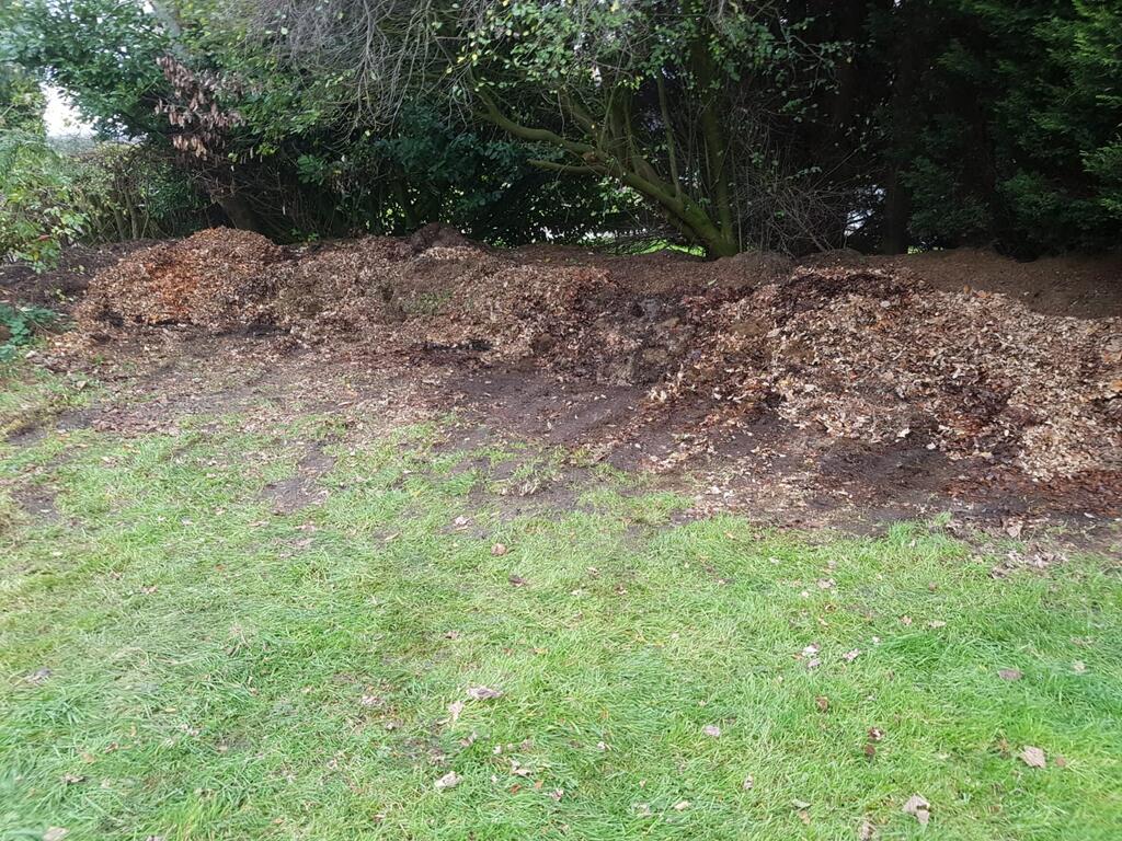

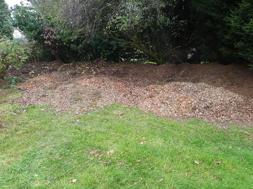

Sutty 100 #39 Posted November 12, 2022 (edited) I have an area similar to that, below. It is in the field, behind the trees from the lawn. Was spread out a little far, encroaching on the field grass, which is cropped for hay, annually, so took the deck off and refitted my plough blade today, and pushed it back a bit. It would have been more effective with the tractor wheels fitted, but I was lazy, and left the lawn wheels on, causing me to keep slipping, as it built up in front of me. Quick job for tomorrow I suppose. Haven't made a baffle for the cub cadet rear discharge chute yet. Can't find anything appropriate, but I'll keep thinking. Lawns are pretty clear right now, but very surprisingly, for mid November, there is still an awful lot of leaves in the trees, still to come down. Edited November 12, 2022 by Sutty 3 1 Share this post Link to post Share on other sites
