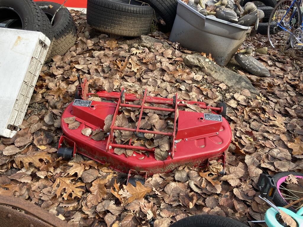

TonyToro Jr. 1,952 #1 Posted November 6, 2022 I’m wondering what this rear discharge deck fits? It looks like it wasn’t used much 2 Share this post Link to post Share on other sites
The Freightliner Guy 1,358 #2 Posted November 6, 2022 (edited) What does the underside look like . also rust seems almost nonexistent. Edited November 6, 2022 by The Freightliner Guy Share this post Link to post Share on other sites

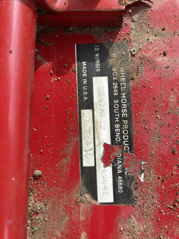

daveoman1966 3,839 #3 Posted November 6, 2022 That rear disch deck model 05-42MR02 will hang on most any Horizontal shaft engine Wheelhorse / Toro made from 1973 to the last model year. (Will work on 1972 & older tractors if the belt drive system on THAT TRACTOR is modifed.) It has the pretty-much universal Tach-O-Matic attachment setup. Suitable for 10hp or more engine. It can also be converted to work on tractors with Vertical Shaft engines. 1 3 Share this post Link to post Share on other sites
TonyToro Jr. 1,952 #4 Posted November 6, 2022 Sooooo your saying it will fit on a C-145 2 Share this post Link to post Share on other sites
Jeff-C175 7,206 #5 Posted November 7, 2022 (edited) 21 minutes ago, TonyToro Jr. said: Sooooo your saying it will fit on a C-145 Absolutely. Same deck I use on a C-125. (used to live in S. Glastonbury) Edited November 7, 2022 by Jeff-C175 3 Share this post Link to post Share on other sites
TonyToro Jr. 1,952 #6 Posted November 7, 2022 Thanks guys for the help!!! 3 Share this post Link to post Share on other sites
