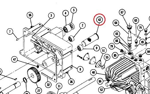

953 nut 63,634 #4 Posted October 29, 2022 Take a look at this manual. If there is a strainer it would be in the transaxle but I don't think there is one. Share this post Link to post Share on other sites

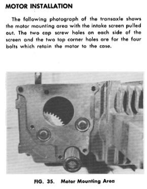

gwest_ca-(File Mod) 11,932 #5 Posted October 29, 2022 Found this in the Sundstrand service manual 3 Share this post Link to post Share on other sites
pfrederi 19,523 #6 Posted October 30, 2022 You have to pull the hydro motor to access it. 1 Share this post Link to post Share on other sites
