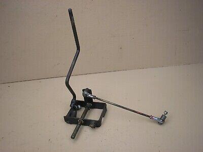

Pcyco13 4 #1 Posted October 28, 2022 I have a 416-H with a front loader. Is there an adjustment for the linkage or drive belt? It's the slow boat to China in forward and I'm wondering if this can be adjusted. It seems to go faster in reverse. Is a new drive belt a solution? 1 Share this post Link to post Share on other sites
Ed Kennell 44,997 #2 Posted October 28, 2022 Make sure the big cam nut is moving completely end to end in the cam plate slot. 2 Share this post Link to post Share on other sites
Pcyco13 4 #3 Posted October 28, 2022 Thanks! I'll check it out and let you know if that was the problem. 1 Share this post Link to post Share on other sites
Handy Don 15,994 #4 Posted October 28, 2022 This manual will help... Share this post Link to post Share on other sites
953 nut 64,269 #5 Posted October 28, 2022 Remove the motion control tunnel cover (between your knees) and take a look. Mine wouldn't go very fast in forward when I got it, turns out chipmunks had been nesting there and the front of the tunnel was full of bedding and acorn shells preventing the lever from going all the way forward. 2 2 Share this post Link to post Share on other sites
kpinnc 17,267 #6 Posted October 29, 2022 (edited) 23 hours ago, 953 nut said: Remove the motion control tunnel cover (between your knees) and take a look. Agreed 100%. My 520 has the same issue and needs adjustment there almost every year. I'm about ready to remove the dash control lever altogether and install one on the lower shifter area. At least there won't be anymore extra linkages to contend with... Edited October 29, 2022 by kpinnc 1 Share this post Link to post Share on other sites
