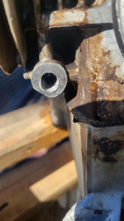

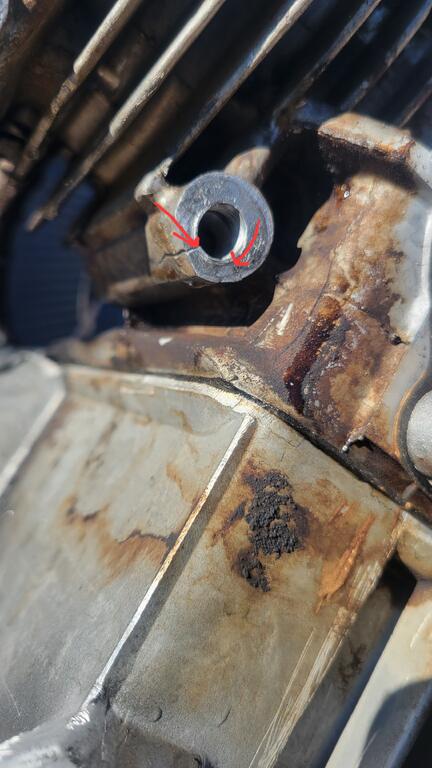

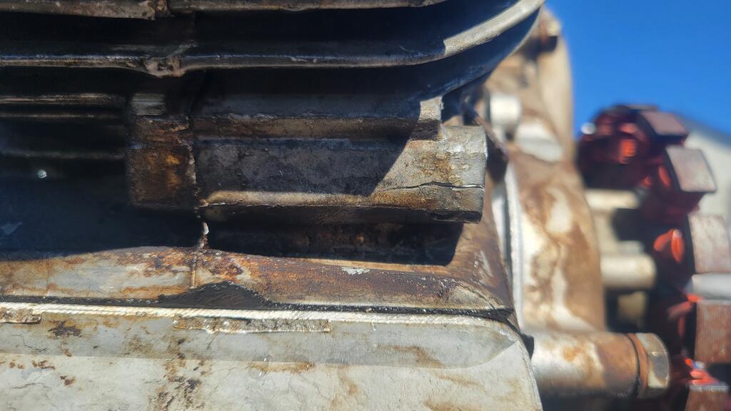

Heatingman 977 #44 Posted November 19, 2022 6 hours ago, RED-Z06 said: Seller probably didn't know it was a busted block but it wasn't a shipping issue. Its more of a "I should have known" issue. If i could TiG weld id fix it...finding someone willing to mess with it could be difficult Pictures? 1 Share this post Link to post Share on other sites
RED-Z06 2,718 #45 Posted November 19, 2022 1 minute ago, Heatingman said: Pictures? Share this post Link to post Share on other sites
Heatingman 977 #46 Posted November 19, 2022 Looks like cast aluminum. Be a real pain to weld that. Just get some JB weld, drill a small hole at the far end of the crack to stop the spread of the crack - fill that crack, and the tapped hole, then re-drill and re-tap the hole. Share this post Link to post Share on other sites
oliver2-44 11,515 #47 Posted November 19, 2022 5 minutes ago, Heatingman said: Looks like cast aluminum. Be a real pain to weld that. Just get some JB weld, drill a small hole at the far end of the crack to stop the spread of the crack - fill that crack, and the tapped hole, then re-drill and re-tap the hole. Good idea, but instead in of retapping the hole, would it work to JB weld a stud in there? Share this post Link to post Share on other sites
RED-Z06 2,718 #48 Posted November 19, 2022 9 minutes ago, Heatingman said: Looks like cast aluminum. Be a real pain to weld that. Just get some JB weld, drill a small hole at the far end of the crack to stop the spread of the crack - fill that crack, and the tapped hole, then re-drill and re-tap the hole. Thankfully its not tapped, bolt passes through and threads into the starter. Unfortunately, by design, all the stress on the starter pulls it straight down and they clearanced the bottom of the boss to clear the starter housing...its pretty thin there. I stood there for a half hour with JB in my hand contemplating doing a fill and drill..but, with how that part is so weak..i dont think JB would do it, its a very poor design shared by all onan P-series Share this post Link to post Share on other sites
RED-Z06 2,718 #49 Posted November 19, 2022 6 minutes ago, oliver2-44 said: Good idea, but instead in of retapping the hole, would it work to JB weld a stud in there? No access to put a nut on and any starter work would require pulling the engine and flywheel. Its hard to describe how bad this design is...but when its all together and not broken, if the engine kicks back at all? The whole thing somehow flexes Share this post Link to post Share on other sites
Heatingman 977 #50 Posted November 19, 2022 31 minutes ago, RED-Z06 said: Thankfully its not tapped, bolt passes through and threads into the starter. Unfortunately, by design, all the stress on the starter pulls it straight down and they clearanced the bottom of the boss to clear the starter housing...its pretty thin there. I stood there for a half hour with JB in my hand contemplating doing a fill and drill..but, with how that part is so weak..i dont think JB would do it, its a very poor design shared by all onan P-series Are you saying the starter sits below that hole? If so how close? Im thinking you could reinforce that extrusion by wrapping that cracked area with steel tube with a bore diameter just over the size of the extrusion. Ideally a purpose made bushing, but a Piece of conduit, maybe some washers stacked up, even a worm drive clamp would add a ton on tensile strength. Cast aluminum that thin just does not have that much shear strength. 1 Share this post Link to post Share on other sites
