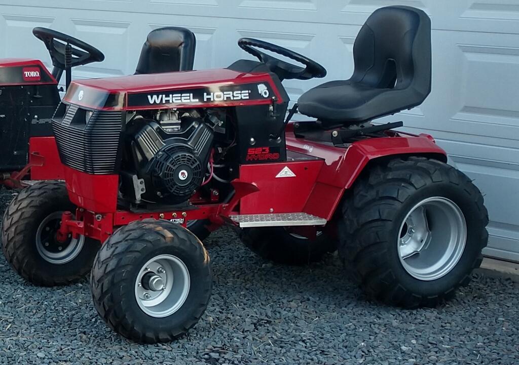

WHX?? 54,987 #4 Posted October 24, 2022 I would repo. Don't get me wrong I too love the power of a fine running Onan but there ain't shop around here for 400 miles that would touch it so that means I DIY. Which is no problem. I have a decent machinist in my back pocket and I know the whole thing would be done right. The biggy for me is the cost of parts. Personally I would do a predator or if the rest of the tractor was in really good shape and I am in love with her might spring for the Vanguard. I would never do a used Onan unless I was 200% sure I had a warm fuzzy feeling about it. Know where yer coming from Red... been there. 1 Share this post Link to post Share on other sites
RED-Z06 2,716 #5 Posted October 25, 2022 1 hour ago, WHX?? said: I would repo. Don't get me wrong I too love the power of a fine running Onan but there ain't shop around here for 400 miles that would touch it so that means I DIY. Which is no problem. I have a decent machinist in my back pocket and I know the whole thing would be done right. The biggy for me is the cost of parts. Personally I would do a predator or if the rest of the tractor was in really good shape and I am in love with her might spring for the Vanguard. I would never do a used Onan unless I was 200% sure I had a warm fuzzy feeling about it. Know where yer coming from Red... been there. The only problem with the predator is its not a bolt in kit, you have to modify the exhaust quite a bit, figure out the 1" to 1-⁷/16 crank adapter, figure out the driveshaft adapter and raise the engine 1.5"...on top of the electrical connector and having to go to a ground kill ignition switch. Its not bad its just...stuff 1 Share this post Link to post Share on other sites

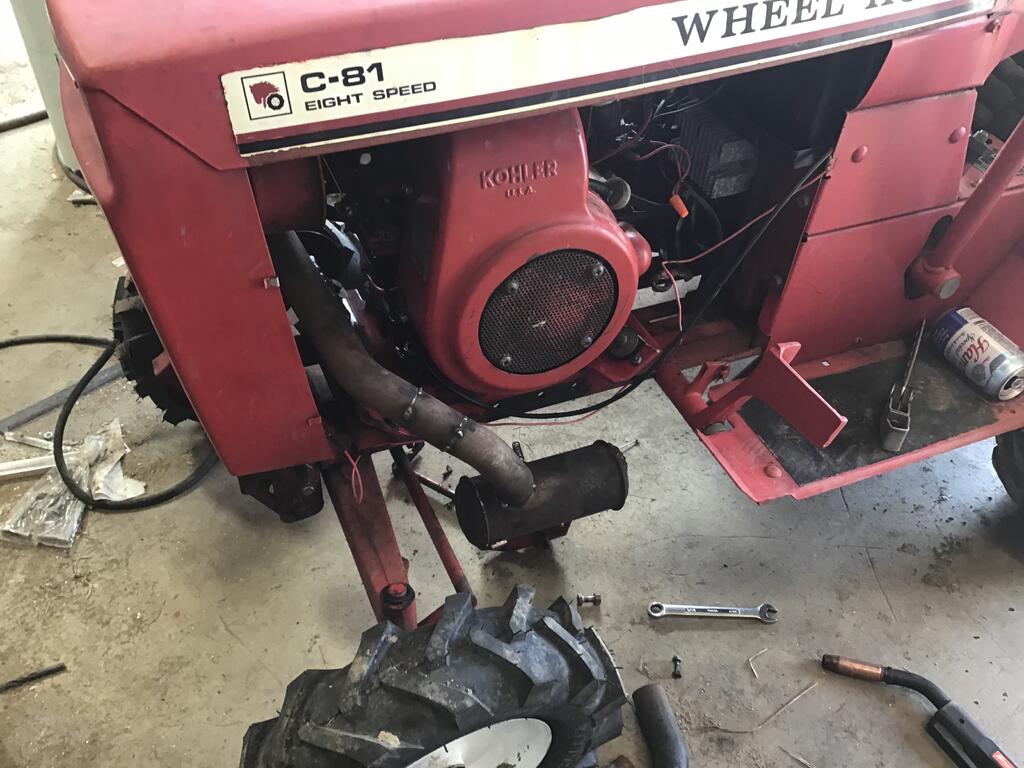

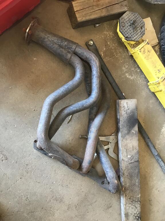

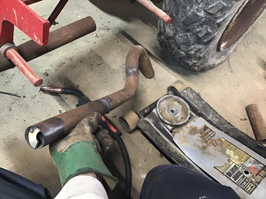

Pullstart 68,882 #13 Posted October 25, 2022 (edited) @RED-Z06 what model are we talking about here? P220 told me 520H but shaft drive? Xi? Not ? They have crank adapters for the driveshaft flange available for the Predators… and it would still get you driving new for less than $1k. For exhaust, do you have a welder? If not, pick one of those up and find yourself some swap meet V8 headers to cut up and use to build the exhaust. It’s pretty fun! You could do this for less than $2200 and be ahead on tools. Edited October 25, 2022 by Pullstart 1 Share this post Link to post Share on other sites

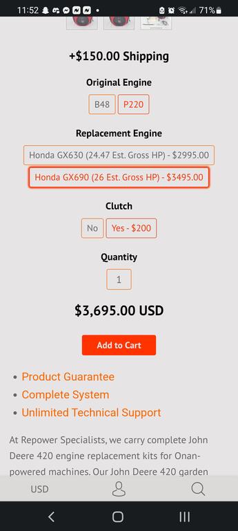

Red-Bovine 337 #15 Posted October 25, 2022 I replace the P220 on our 1992 520H back in 2013 with a Honda GX630 from Repower Specialists in Eugene, OR. The engine and kit was about 2K back then. It has been great and reliable. Got tired of valve seats coming loose, Yes, I really like the Onan, but the Honda is great. 2 1 Share this post Link to post Share on other sites
RED-Z06 2,716 #16 Posted October 25, 2022 Its a non wheel horse unfortunately, can't find XI models anywhere here, and 520s are rare as hens teeth. Share this post Link to post Share on other sites
RED-Z06 2,716 #17 Posted October 25, 2022 25 minutes ago, Red-Bovine said: I replace the P220 on our 1992 520H back in 2013 with a Honda GX630 from Repower Specialists in Eugene, OR. The engine and kit was about 2K back then. It has been great and reliable. Got tired of valve seats coming loose, Yes, I really like the Onan, but the Honda is great. The GX honda was an option for replacement but at the moment also unavailable...but they have shot up to 2799, the Kohler is 3199 last i looked...its gotten ridiculous Share this post Link to post Share on other sites
