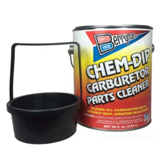

Docwheelhorse 2,792 #1 Posted October 24, 2022 (edited) Hello All, I want to start working on the barn find 953 I picked up... problem number one---the gas tank is full of the worst smelling syrupy green disaster of what once was gasoline... taking gas tank out isn't an option as it is a serious P.I.T.A. So---is there anything chemical wise that I could fill the tank with that would cut this crud? Do I drain it best I can... slosh around some fresh gas to get the rest of it out then fill tank with 2 or 3 gallons of this stuff? Or 2 or 3 gallons of Acetone or should I just rinse it out best I can with gas then jam a pressure washer in the opening with a large amount of Dawn dishwashing soap? Help...…. Tony Edited October 24, 2022 by Docwheelhorse Fixed Picture Share this post Link to post Share on other sites
