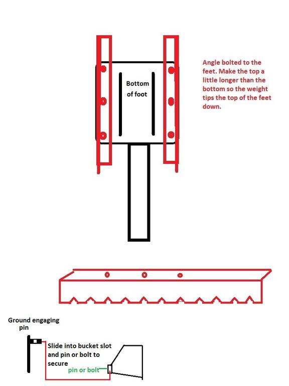

ebinmaine 80,757 #26 Posted October 25, 2022 1 hour ago, wallfish said: Maybe cut teeth into the angle? Around HERE it's ok if the teeth are more aggressive. Not for everyone of course. I was thinking of going even a little further and making larger more pointy shark like teefses. 1 hour ago, wallfish said: I was also thinking about adding pins bolted or clipped to the front bucket Another interesting thought there. 1 Share this post Link to post Share on other sites
wallfish 20,619 #27 Posted October 25, 2022 (edited) Run a weld bead on the bottom edges of any teef you make to make them hard. Points will wear pretty quick by grinding hard into the dirt and rocks so don't get too sophisticated. They'll bend over a lot easier too Edited October 25, 2022 by wallfish 1 Share this post Link to post Share on other sites
ebinmaine 80,757 #28 Posted October 25, 2022 17 minutes ago, wallfish said: don't get too sophisticated I don't see that being an issue. 1 Share this post Link to post Share on other sites
Handy Don 17,484 #29 Posted October 25, 2022 1 hour ago, wallfish said: Most of the digging in is caused by the tractor being pulled back towards the hole. Too much float by making it too big will probably skid them across the top of the ground more. They need to dig in some to hold. Maybe cut teeth into the angle? see below I was also thinking about adding pins bolted or clipped to the front bucket. Added to the magic drawing LoL Having the front bucket ALL the way down lifting the front puts the entire weight of the tractor on the hoe bucket and and helps to keep it from moving back Interesting idea to try pinning the bucket to the ground--keeps the force through the subframe. 2 Share this post Link to post Share on other sites
wallfish 20,619 #30 Posted October 25, 2022 6 minutes ago, ebinmaine said: I don't see that being an issue. LoL My point (see how I did that) being that making them simple, easy to make, easy to change and as a sacrificial part purpose might make sense. 1 Share this post Link to post Share on other sites
