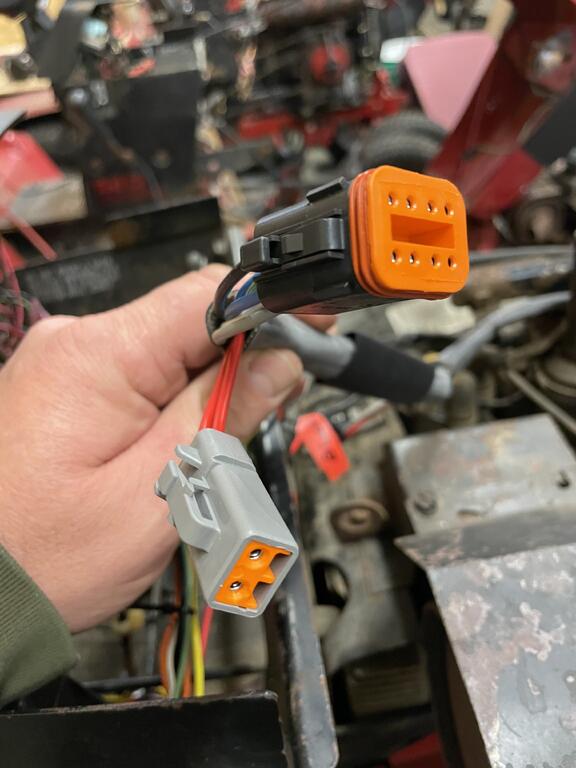

Bow_Extreme 580 #1 Posted October 16, 2022 Due to request demand: 520 Wheel Horse Onan Deutsch Connector Info: Engine Side Connectors: Starter & Charging - 2 Red 14ga. Wires 2-Pin Socket(Female) Connector Connector Part Number: DTP06-2S Wedge lock Part Number: WP-2S Socket Part Number(12-14ga.): 0462-203-12141 Connector Link: https://www.customconnectorkits.com/dtp06-2s/ Wedge Lock Link: https://www.customconnectorkits.com/wp-2s/ Socket Link: https://www.customconnectorkits.com/0462-203-12141/ Remaining 7 wires 8-Pin Socket(Female) Connector Connector Part Number: DT06-08SB Wedge lock Part Number: W8S Socket Part Number(16-20ga.): 0462-201-16141 Connector Link: https://www.customconnectorkits.com/dt06-08sb/ Wedge Lock Link: https://www.customconnectorkits.com/w8s/ Socket Link: https://www.customconnectorkits.com/0462-201-16141/ Tractor Side Connectors: Starter & Charging - 2 Wires 2-Pin Plug(Male) Connector Connector Part Number: DTP04-2P Wedge lock Part Number: WP-2P Pin Part Number(12-14ga.): 0460-204-12141 Connector Link: https://www.customconnectorkits.com/dtp04-2p/ Wedge Lock Link: https://www.customconnectorkits.com/wp-2p/ Pin Link: https://www.customconnectorkits.com/0460-204-12141/ Remaining 7 wires 8-Pin Plug(Male) Connector Connector Part Number: DT04-08PB Wedge lock Part Number: W8P Pin Part Number(16-20ga.): 0460-202-16141 Connector Link: https://www.customconnectorkits.com/dt04-08pb/ Wedge Lock Link: https://www.customconnectorkits.com/w8p/ Pin Link: https://www.customconnectorkits.com/0460-202-16141/ Connectors: You can choose slight variations on part numbers based on black, grey, or extra tight seal. Sockets & Pins: You can also choose variations of pin sizes and types. There are gold plated pins as well. The more specialized, the more expensive. There is also a custom built tool for crimping pins and sockets. For those of us who work on a lot of wiring or maybe have a little more money to spend, this tool is invaluable. You pay for quality. There are other tools that are slightly cheaper and work as well. This tool makes this crimp job exceptionally quick and you cannot pull the pin/socket off the wire. This is a 4-jaw crimp tool. Tool Link: https://www.customconnectorkits.com/hdt-48-00/ Other areas to check for the crimp tools: Facebook Marketplace. I bought 2 brand new sets @ a 1/4 of the price of 1 tool. 6 1 Share this post Link to post Share on other sites
Pullstart 68,787 #2 Posted October 17, 2022 You’re an Ace Matt! 1 Share this post Link to post Share on other sites
peter lena 9,727 #3 Posted October 17, 2022 @Bow_Extreme nice follow up on that ! makes it a go to spot for that trouble area , pete 1 Share this post Link to post Share on other sites
