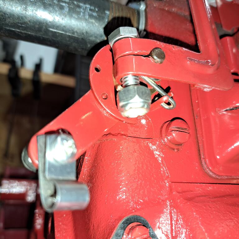

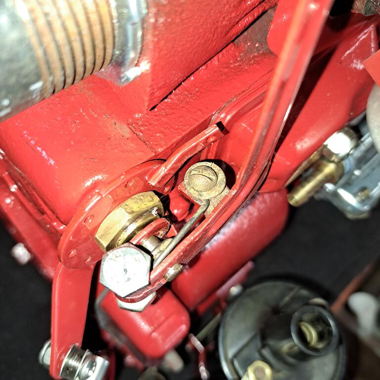

rmaynard 17,527 #26 Posted October 11, 2022 1 hour ago, Handy Don said: Thanks for the images, Bob. I've not seen the plastic inserts in the governor arm and throttle plate arm before. Combined with the spring, this must be a really smooth mechanism. I'll have to look around for some of those! The connection of the throttle from below that doesn't use the little lever on the governor arm must need extra resistance to hold the throttle open! This is the best running K181 that I own. 1 Share this post Link to post Share on other sites
rmaynard 17,527 #27 Posted October 11, 2022 1 hour ago, WHX?? said: Interesting Bob. Pros and cons of coming over the top versus the bottom? Over top should be a shorter cable = less cable friction? Over the top enables one to use that extended tab/hole. I believe the Kohler manual shows the bottom way. Mine are rigged both ways. Not seeing the purpose of that spring in 2nd pic when there That's is a solid link. That's the way it was when I got the tractor. Share this post Link to post Share on other sites

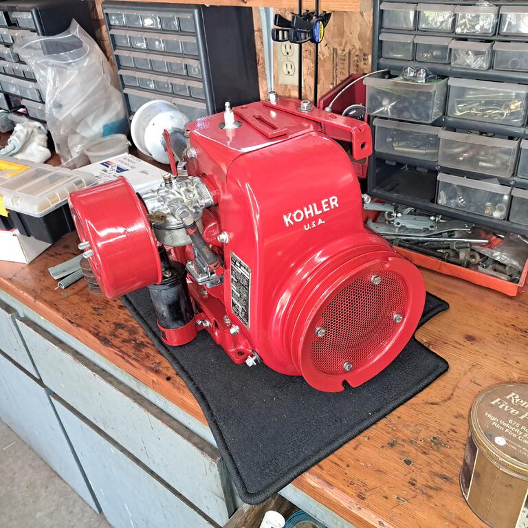

WHX?? 57,808 #28 Posted October 11, 2022 Best shots I could get... 1 Share this post Link to post Share on other sites
Handy Don 17,316 #29 Posted October 11, 2022 2 hours ago, WHX?? said: Not seeing the purpose of that spring in 2nd pic when there is a solid link. That is a very light spring and all it does is take play out of the linkage by keeping the two arms tight to the linking wire. Share this post Link to post Share on other sites
Sled Man 15 #30 Posted October 11, 2022 3 hours ago, WHX?? said: The manual does show how it all goes together and adjustment. I got a fresh build on the bench I'll get a pic. Thank you that would be greatly appreciated. I think I have my mind wrapped around how it should be set up and will work. Share this post Link to post Share on other sites
Snoopy11 5,731 #31 Posted October 11, 2022 1 hour ago, WHX?? said: Bet that takes a good bit of spark plug wire to go from the base of the motor all the way up to the head... Don Share this post Link to post Share on other sites
Heatingman 977 #32 Posted October 15, 2022 On 10/11/2022 at 12:27 PM, Snoopy11 said: Bet that takes a good bit of spark plug wire to go from the base of the motor all the way up to the head... Don Probably not much choice in locational, big old starter gen goes on the other side of the motor. 1 Share this post Link to post Share on other sites
