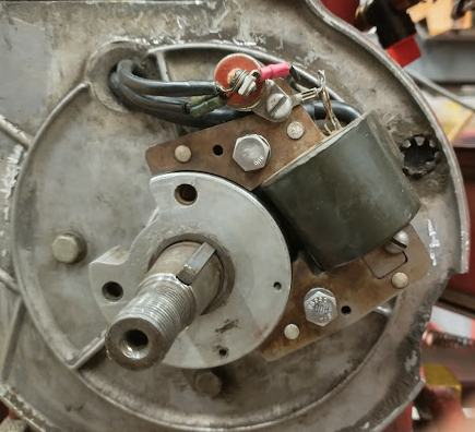

rmaynard 17,433 #26 Posted October 21, 2022 Never did see what the magneto set-up looked like under your flywheel. Here is a picture of my K161 before I found why I had no spark. Is this the same as yours? Share this post Link to post Share on other sites
Heatingman 977 #27 Posted October 21, 2022 Is there a kill switch circuit? Could that be shorted, or intermittently shorted? Share this post Link to post Share on other sites
Junior Marbles 17 #28 Posted October 21, 2022 10 hours ago, rmaynard said: Never did see what the magneto set-up looked like under your flywheel. Here is a picture of my K161 before I found why I had no spark. Is this the same as yours? Something like it, but my condenser is on the outside. I will take a pic as soon as it stops raining . Share this post Link to post Share on other sites
Junior Marbles 17 #29 Posted October 21, 2022 5 hours ago, Heatingman said: Is there a kill switch circuit? Could that be shorted, or intermittently shorted? There is a kill switch and it works as it should. I even disconnected its wire where it ties into the coil secondary. Needless to say: no effect. Share this post Link to post Share on other sites
