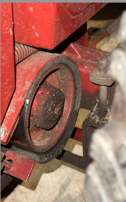

Handy Don 16,752 #26 Posted November 17, 2025 11 hours ago, DBlackston said: You can see the issue I have with the 3 speed band. It just doesn't fit the drum very well. Maybe there is enough contact for it to work though? That appears to be the correct band. Contact between the brake lining and the drum a bit over ¾ of the circumference is normal and plenty to lock the wheels if the lining is in good condition. This is how the 3-speed and 6-speed setup looks. 1 Share this post Link to post Share on other sites

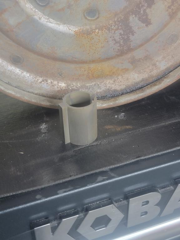

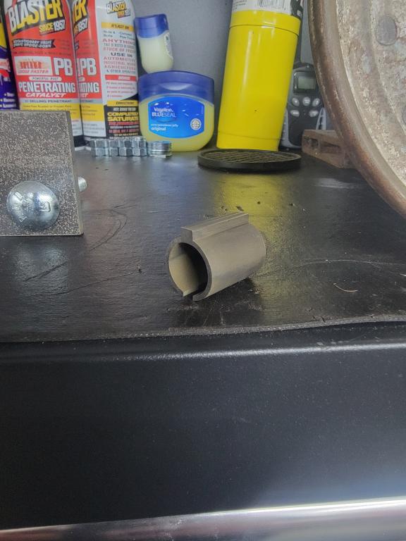

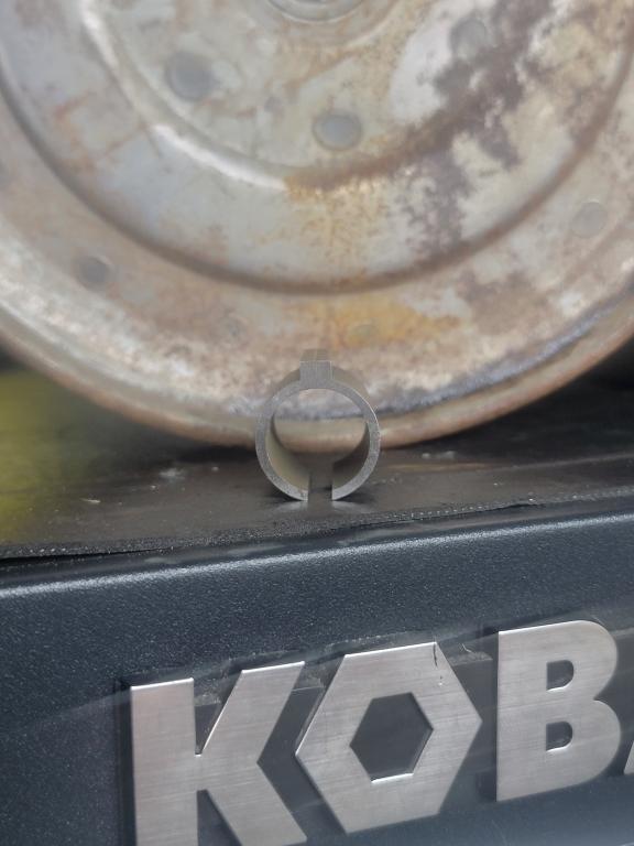

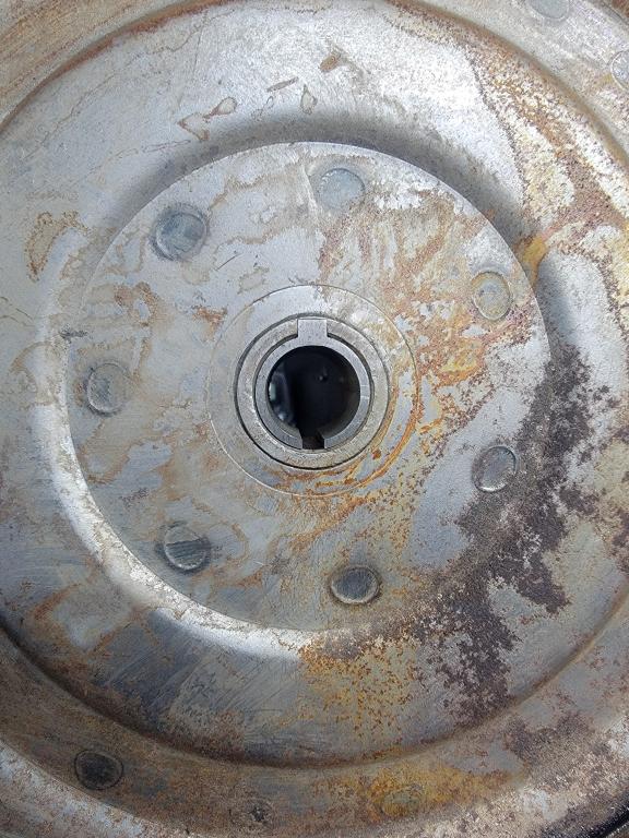

DBlackston 333 #27 Posted November 23, 2025 I was able to get the adapter cut on the EDM by a coworker today. It fits like a dream in the SR-64 pulley. Haven't tried it on the transmission side yet, have some more paint to clean off before I get to that. One step closer to getting the 8 speed swap completed with the additional SR-64 swap! 2 1 Share this post Link to post Share on other sites
