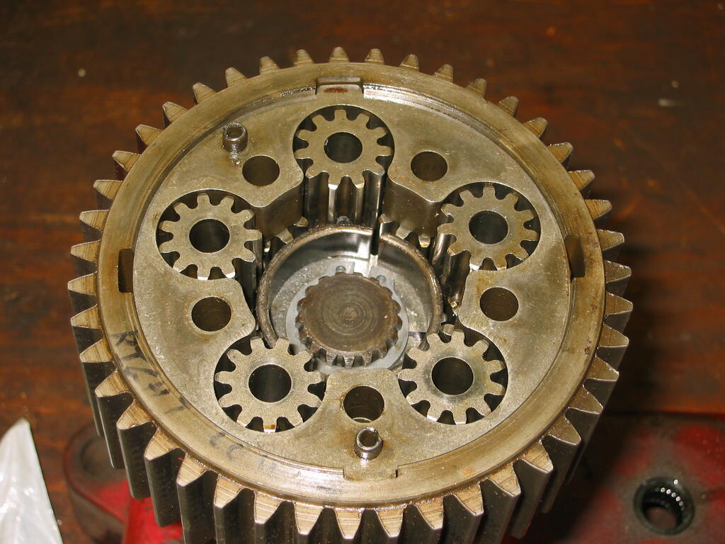

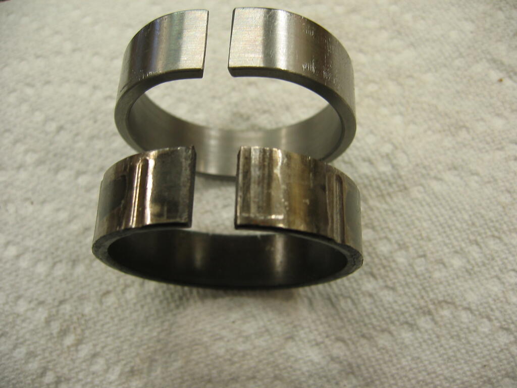

pfrederi 21,005 #2 Posted September 22, 2022 LTD slip has 10 pinions and a heavy spring to limit slippage... 3 1 Share this post Link to post Share on other sites
pfrederi 21,005 #4 Posted September 22, 2022 The Raider 8 and 10 will have an open differential . Will have only 4 pinions 1 Share this post Link to post Share on other sites
stevasaurus 23,785 #5 Posted September 22, 2022 (edited) Not sure what you are asking TJ, but the Sundstrand automatics and the manual WheelHorse transmissions that have limited slip use the same 10 pinion differentials (that is where the Limited Slip is). If you have 8 or 4 pinions, you have regular differentials...and you can have all three differentials in the Sundstrand transaxles. Check manuals to see what is factory...if it is not factory, you are on your own. If you are talking Peerless or Eaton or something else, you are also on your own. Edited September 22, 2022 by stevasaurus 2 Share this post Link to post Share on other sites
