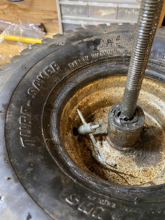

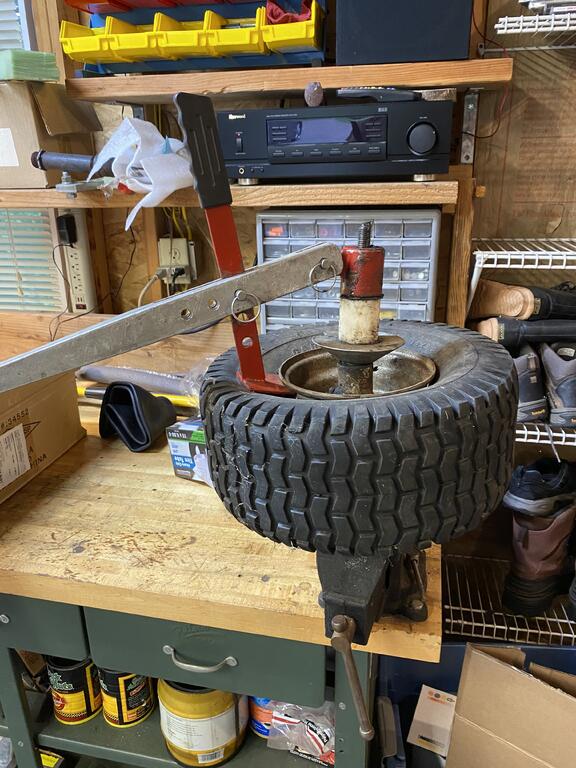

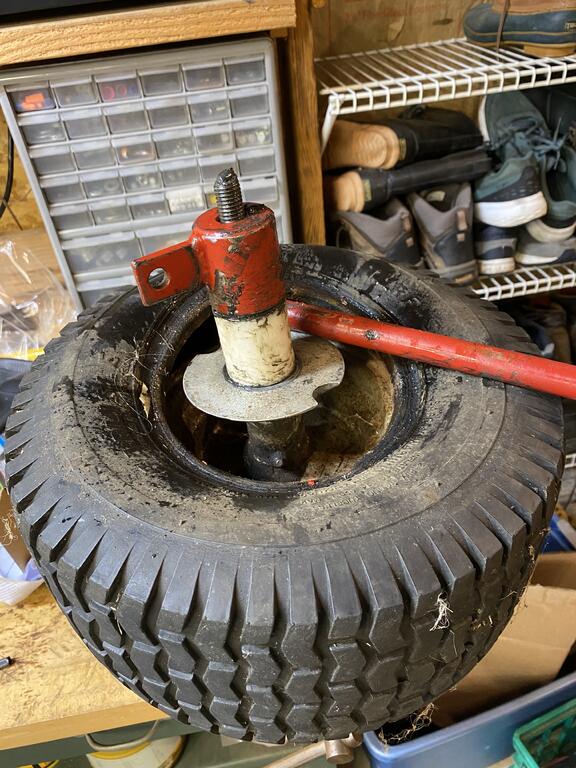

Sparky-(Admin) 23,903 #1 Posted September 21, 2022 Told a friend I would tube her front tire off her WH 310 that goes flat every couple days. The tractors a 1987 and so is the tire. I was assuming it was an 8” which is the smallest my Harbor Freight tire contraption is supposed to handle. But nope..it was a 6” front. Talk about tough to dismount, insert the tube and remount!! I broke both beads but only peeled one side off the rim. I was wiped out after wrestling with it in the garage. It’s small size and the fact that it was old just made it worse. In the end I won 8 Share this post Link to post Share on other sites
