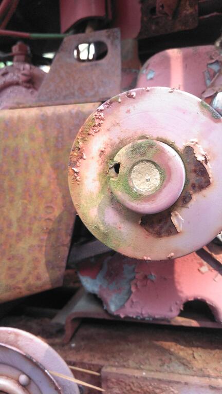

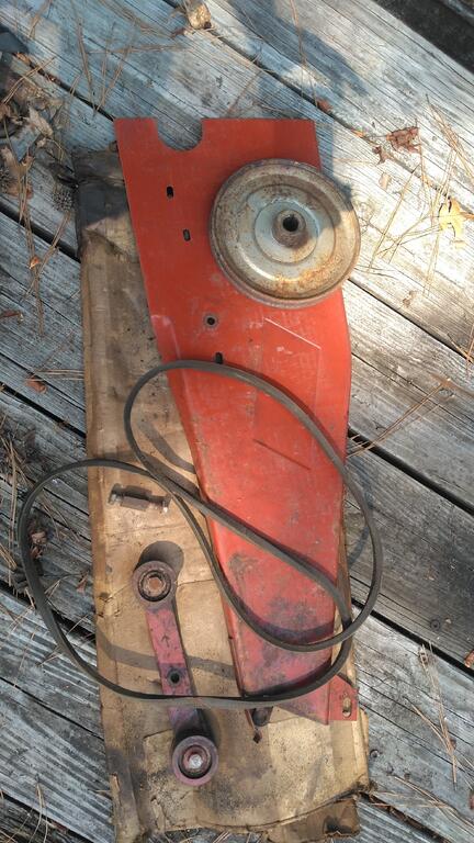

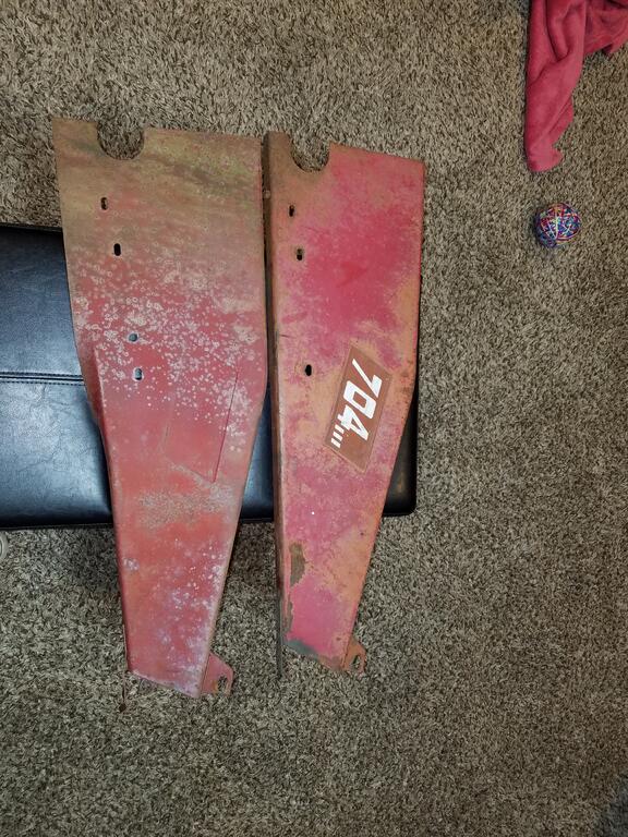

Wild Bill in VA 1,546 #1 Posted September 18, 2022 I was asked about the SR-64 Speed Reduction kit by a member here and I knew they made 2 versions, the first was for the early 1960's models and the second was for the late 1960's models. Well, what could be the difference I mean it consisted of a big 7-inch transmission drive pulley, 2 idler pulleys and a bent belt guard ???? Now the early 1960's Wheel Horse models did not use the metal tang at the lower front of the belt guard used to slow the belt speed down to shift gears and from 1965 and later Wheel Horse models used a 2-inch metal tang on the lower part of the belt guard up at the output pulley of the engine to slow the belt down. The belt guard was made with 2 front mounting points, 1 for the Tecumseh and 1 for the Kohler engines. With the 7-inch drive pulley the tractor could move at a much slower rate that would be needed for snow blowing or using a tiller. Wild Bill in Richmond VA 1 3 2 Share this post Link to post Share on other sites

ri702bill 11,346 #6 Posted September 18, 2022 The only drawback folks - you are stuck in low range until you put it back to original - it is NOT a 6 or 8 speed..... 1 Share this post Link to post Share on other sites

DBlackston 323 #11 Posted October 1, 2022 (edited) I'm putting an 8 speed in my 704. Maybe I should put a speed reducer kit on it? Then I could really run a tiller slow! I already have a cover but never could find an input pulley and idler bar. Edited October 1, 2022 by DBlackston Share this post Link to post Share on other sites

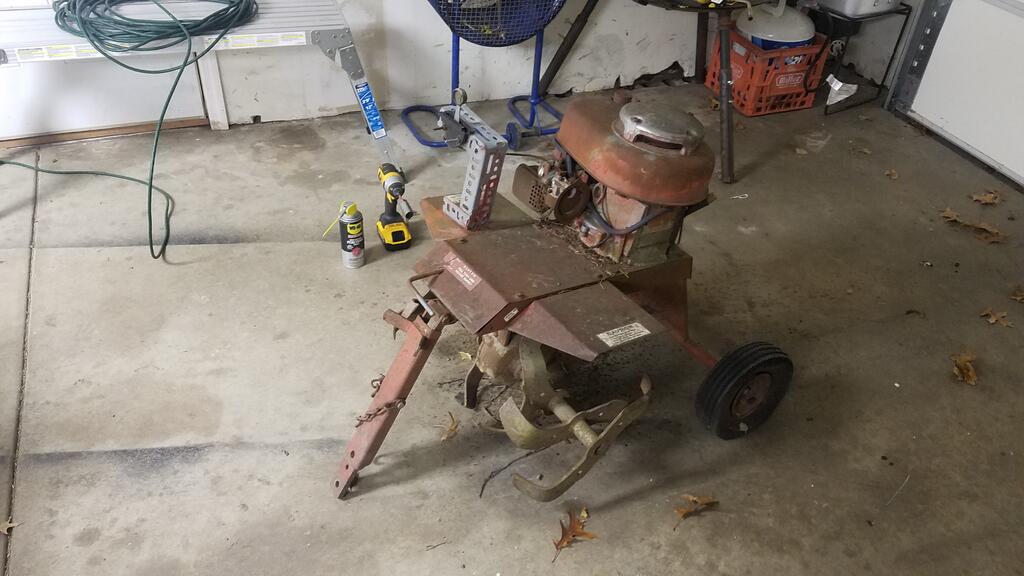

DBlackston 323 #14 Posted October 1, 2022 Bill, I just received your speed reducer kit. I am one step closer to running my WT-244 behind my 854. Now I am on to search for a V60 Tecumseh for the tiller. Thanks for selling it to me! 1 Share this post Link to post Share on other sites
