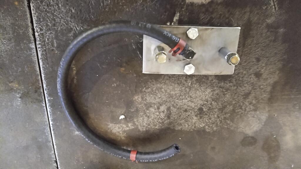

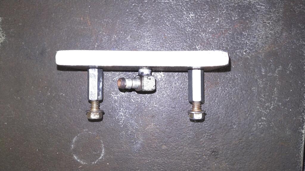

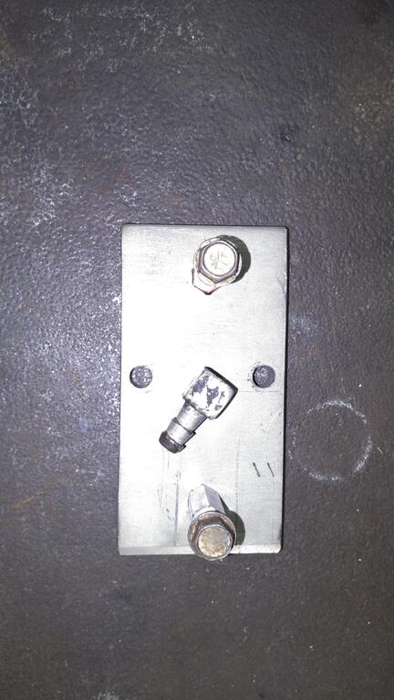

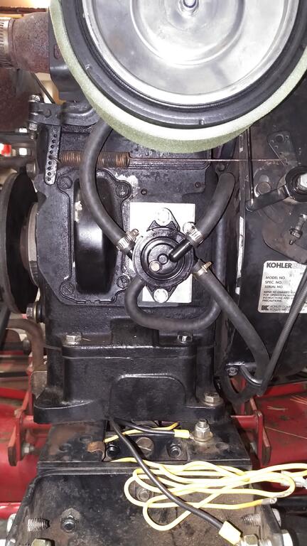

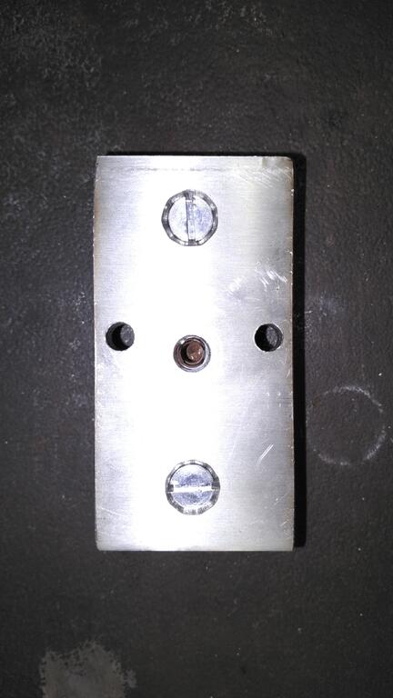

Bill D 2,363 #7 Posted September 18, 2022 Convert to an vacuum impulse pump. They work great. If you go this route use a genuine Briggs or Kawasaki pump. They are made in Japan and very good quality. Make a mounting plate and mount it as shown. 2 Share this post Link to post Share on other sites
Bill D 2,363 #8 Posted September 19, 2022 More mounting plate pics. Not my best fab work, but it gets the job done. I put one of these on my Dad's 312-8 and one on a 312-8 I sold to my neighbor. Both are still going strong. 1 Share this post Link to post Share on other sites
