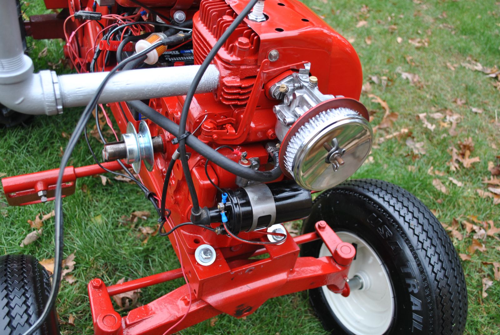

This is a custom 604 with a 8hp Kohler electric start engine. I had to move the engine forward an inch to allow room for the starter. Then had to mount the coil up front and install the voltage regulator and the solenoid under the fuel tank base. I also had to make a custom air filter so the hood would fit. Then added a suburban steering wheel. Had to use a longer drive belt and a smaller engine pulley.
