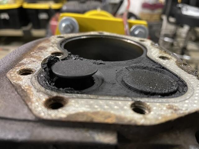

ri702bill 12,841 Posted August 3, 2022 Quite the carbon formation - time to pull both valves to check for valve / seat damage.... Bill Share this comment Link to comment
TractorEd 675 Posted August 12, 2022 On 8/3/2022 at 7:10 AM, ri702bill said: Quite the carbon formation - time to pull both valves to check for valve / seat damage.... Bill I've rebuilt the engine. This pic was during the tear down! I replaced both valves; engine was bored +10, valve seat resurfaced. New piston/rings, rod. Running great now! Thank you for your comment! 1 Share this comment Link to comment
