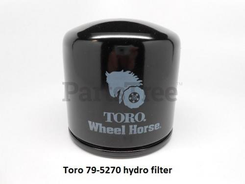

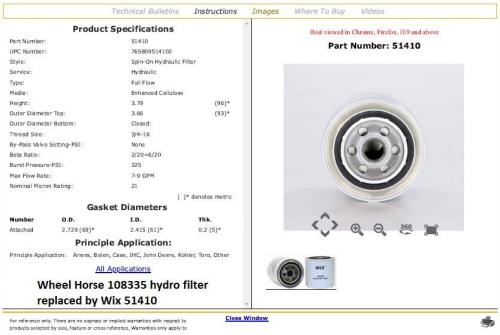

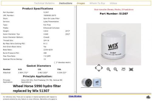

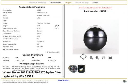

The preferred transmission filter for all models is a Wix 51410 or Napa 1410 because it does not have a by-pass valve
Wheel Horse 5990 (1965-1973) replaced by Wix 51307
Wheel Horse 102819 (1973-1982) replaced by Wix 51521
Wheel Horse 108335 (1980-1991 ) replaced by Wix 51410
Wheel Horse 79-5270 (1992 - on) replaced by Wix 51521
