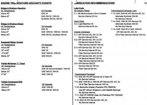

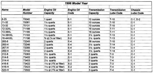

Lube chart SS
1996 12-32XL model 71182 Serial 6900001-6999999
1996 12-32XL model 71188 Serial 6900001-6999999
1996 12-32XL model 71201 Serial 6900001-6999999
1996 12-32XLe model 71201 Serial 6900001-6999999
1996 12-38XL model 71184 Serial 6900001-6999999
1996 13-38XL model 71185 Serial 6900001-6999999
1996 13-38XL model 71205 Serial 6900001-6999999
1996 13-38XLe model 71205 Serial 6900001-6999999
1996 13-38HXL model 71191 Serial 6900001-6999999
1996 14-38HXL model 71193 Serial 6900001-6999999
1996 14-38HXL model 71217 Serial 6900001-6999999
1996 14-38HXLe model 71217 Serial 6900001-6999999
1996 15-44HXL model 71192 Serial 6900001-6999999
1996 16-44HXL model 71196 Serial 6900001-6999999
1996 16-44HXL model 71218 Serial 6900001-6999999
1996 16-44HXLe model 71218 Serial 6900001-6999999
