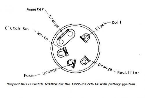

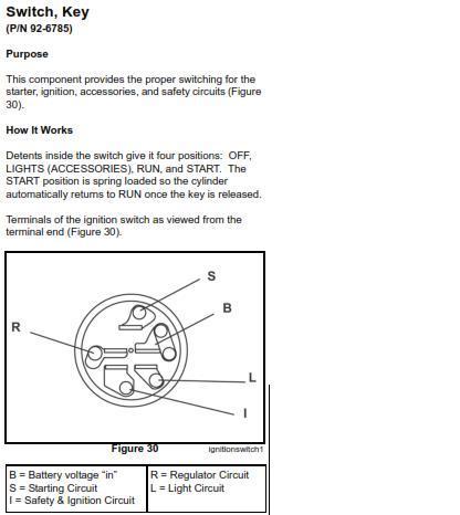

May have used 101876 or 101-876 ignition switch nla Guessing this may work - (101917 5-terminal 4-position S-R-B-I-A) replaced by 92-6785 5-terminal 4-position S-R-B-I-L ignition switch and 8658 replaced by 108544 solenoid
Believe 1972-73 GT-14 used battery ignition and Bendix starter with 101876 ignition switch
Terminals on 101876 battery ignition switch may not be identified - This switch is no longer available from Toro and appears to be a heavy duty switch designed to take a heavy starter load. The ipl's @ Toro also list a 8658 solenoid so a cheaper alternative switch should be available.

92-6785 hould be a suitable replacement ignition switch if a starter solenoid is added

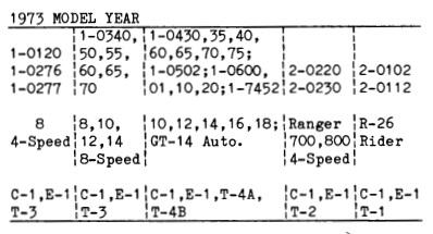

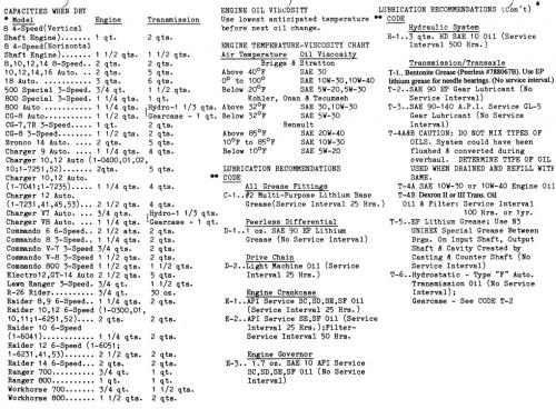

Lube chart SS
1972 Details & Attachments
6 pages 227.35KB

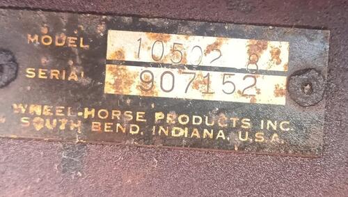

1973 GT-14 model 1-0502-8
1973 serial numbers that have shown up for the 1-0502
0907028
0907058 - This may be a typo for 907068
0907068 - Made in USA - Located in Yorkshire UK
0907151 - Located in Wilmington
0907152
0907189
0907268
0917327 - Located in Sweden
0917361 - Located in the UK
0917373 - Located in Sweden
