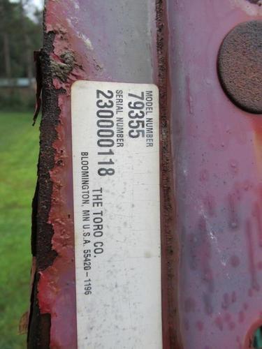

Dozer 2002 48in model 79355 Serial 220000001-220999999
Dozer 2003 48in model 79355 Serial 230000001-230999999
2003 serial numbers that have shown up for the 79355
230000118

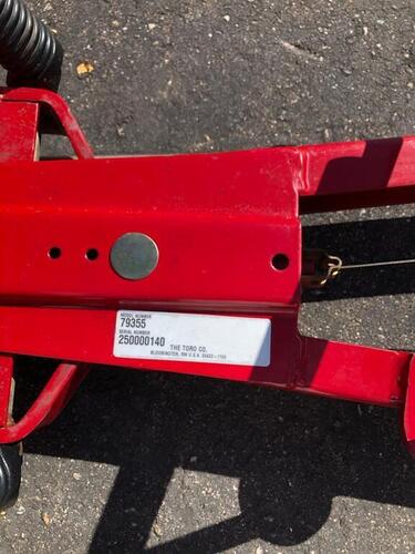

Dozer 2005 48in model 79355 Serial 250000001-250999999
2005 serial numbers that have shown up for the 79355
250000140
